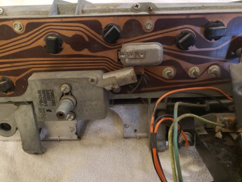

Finally some good weather today, so I took the cluster assembly out and found the voltage limiter and a lot of things that makes me wonder what people are doing to their cars...
Anyway, the new limiter looks a bit different than the old one, but I guess this doesn't matter.
That conductor (is that the right word?) wasn't even connected.
I will also install a new speedometer cable and change all the light bulbs and a few sockets.
Just curious, you said that a lot of people have problems with their fuel/temp gauges, but you didn't say that you had a problem, did or do you? When I replaced the circuit boards in one of my cars, I installed a solid state IVR. My fuel and temp gauges were very lazy when the ignition was turned on. I removed the solid state IVR and reinstalled my old one, the gauges then returned to normal.
The right word is capacitor or some say condenser. It needs to be connected regardless of which voltage limiter you use.

Instrument voltage regulator. It uses the cars 12V and converts it to 5V for your gauges.
Instrument voltage regulator, that's the square one. The round condenser/capacitor is for static in the AM radio. All good answers here. Sounds like your wiring may be a mess from your statement.
