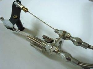

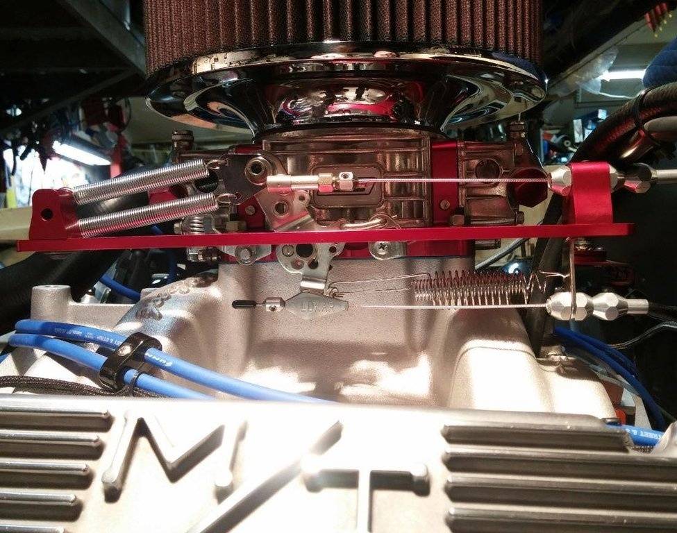

What I'm wondering about is some of these setups have a return spring attached to the kickdown and some don't. If I understand the system correctly, as the throttle lever moves rearward, the bottom, attached to the cable, moves forward, which pulls the kickdown lever rearward, then when the throttle lever moves forward the cable is pushed back, which then pushes the kickdown lever back into place. I can see where a spring would assist to make sure the kickdown disengages, but that seems like it would also be pulling against the throttle lever, making the pedal harder.
You understand correctly. You need a throttle return spring for any carb. The kit just integrates it into the new kickdown brackets. By pulling reward on the bottom (kickdown side) it eliminates the long return spring that would normal be pulling forward on the throttle arm. Cleans up the installation a little.
I can see that for the one kit, but looking at the Lokar systems, they use a bracket that connects to the front of the carb and uses two small springs to replace the one long spring and stock spring bracket, so two smaller springs replace the one big one, but there is no spring on the kickdown lever like there is with the Bouchillon set up. There are also no springs on the lever with any of the other systems I've looked at.
