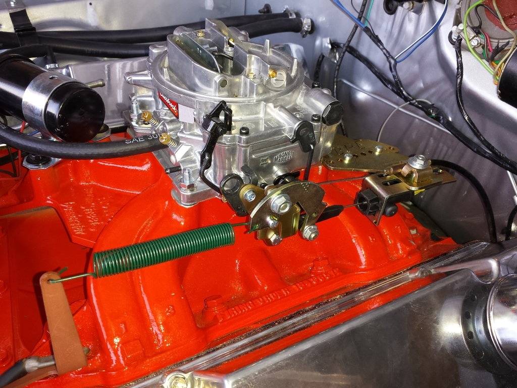

I can see that for the one kit, but looking at the Lokar systems, they use a bracket that connects to the front of the carb and uses two small springs to replace the one long spring and stock spring bracket, so two smaller springs replace the one big one, but there is no spring on the kickdown lever like there is with the Bouchillon set up. There are also no springs on the lever with any of the other systems I've looked at.
I see what you mean. I'm not sure why it's necessary to have a spring down on the transmission with that kit. Interesting.
I really like the Bouchillion kickdown, although it is tight to install if you have headers. I have a spring on my carb as well as on the kickdown trans lever, ehich is lighter.
