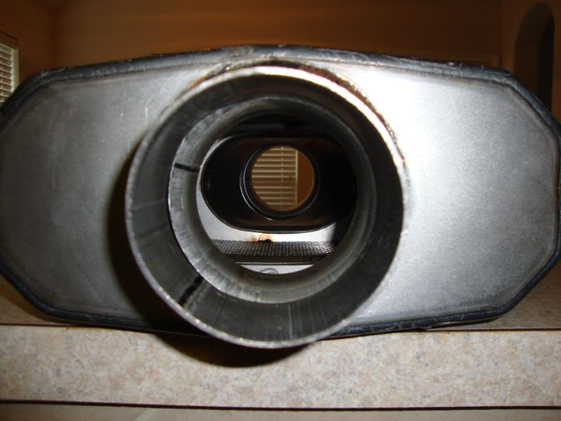

Yeah those rice burners are much louder than my car because they have such an annoying frequency. My car has a deep rumble which is not as loud. I don't think the Aero Chambers will be any quiter than the Noisemasters. Take a look at this picture. Certainly, Aero Chambers alone will not be any quiter than what I run now. Those things look like the intake on the guided missile destroyer I recently served on. The ship had that same kind of design inside the intakes to keep the ship quite despite having 200,000 hp from 4 GTMs plus the 3 GTGs.
