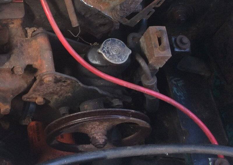

Have an original 69 GTX with a power steering cooler. I don't have the broadcast sheet. Would anyone know the code for it or was it part of a package?

The PS cooler comes with and Axle package. Do you have a fender tag? Or is it a Hemi or 440-4speed car? They all had them with the big engines and 4 speed.
383 isn’t a big engine. 3.23 is not an axle package.
I just asked a smart code and numbers guys this same question and he said the PS cooler is not on a broadcast sheet.
Its a 440 -4 speed Super Track Pack car. Fender tag was decoded, but so far can not find an intact build sheet....rodents took care of them!
IMO....The power steering oil cooler came with the axle package IF the axle ratio was 3.55:1 (3.54:1 for Dana 60) or greater. My RS23V0A ****** 4 speed GTX has the A34 Super track pack. I have the PS/PDB, max cooling radiator, 2806070 torque drive fan clutch and Dana 60 with the 4.10:1 ratio and the PS oil cooler with the Saginaw pump.
