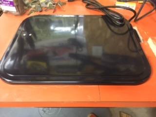

I just bought this little 3 gallon from Summit. I don't have anymore floor space I can give up so this will be better than nothing.
0bf10a7fe202ef401-6161459b9f7c0f1f8a63e8b5486b9ed5&csrf=178fd616ab10cd645dde909055a3ffedfa5f87cc.jpg
I mounted it in my work bench.
It says water based only. Any reason I can't put Mineral Spirts in it?

My guess is the plastic pump may not like some solvents
That's what my concern is... even though Mineral Spirits isn't that harsh, I'm concerned about the pump failing or worse yet... catching fire.
