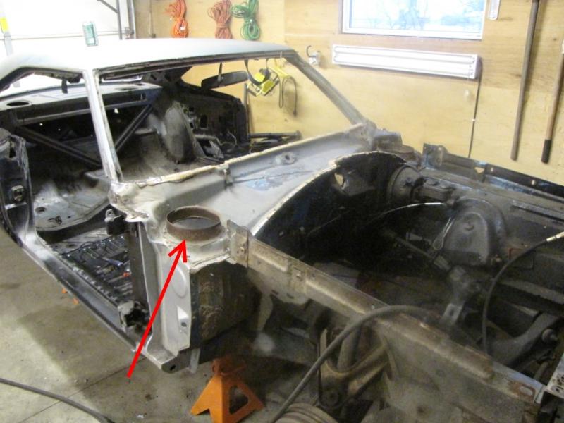

Figured I'd toss this pic up of the "inards" under the outer cowl. May help someone understand what i'm talking about. The red arrow is pointing towards the passenger side plenum. With the shape of the of the inner cowl surface, the area around the plenum is the perfect place for all those leaves, pine needles, dirt, dust and then moisture to collect.....Thus rot out the flimsy 20 guage plenum. You get holes through that, water comes in the cowl vent and travels right through to your floorboards through the fresh air vents. Our cars are notorious for this and yes, it is a bad design.
Fixes.....well, from the pic it's pretty obvious to do it right takes quite a bit of work. Another way would be to block off your air vents or well.....Don't park in the rain and take care when washing her..lol

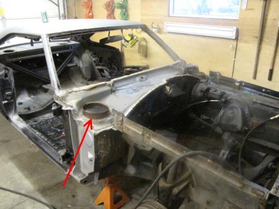

you can cheet and go from the inside with a good sealer.saves the time of pulling all that steel.you just need to pull the cloth vent hose and use a small roller.(i have used bed liner and it works good)
Good tip '67...thanx
Done a couple from the inside by cutting a galvanized piece of metal to fill the hole, sandwich in place using the black tar like Ribbon sealer (like used to seal in rear windows) and then sealed around that with heavy body seam sealer. Told the guys they should be happy if it lasts them 5 years. Just delaying the inevitable.
