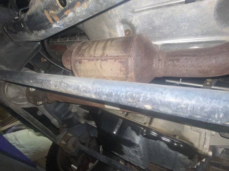

For years, I thought that this was a converter....
The truck has a 5.7, I've owned the truck since it was new. I removed the huge muffler and resonator that were further back when the truck was still new but I never touched the exhaust forward of the Flowmaster you see here:
Automotive Exhaust Pipe Tread Exhaust system Synthetic rubber
Automobile repair shop Synthetic rubber Tread Pipe Automotive Exhaust
I always assumed that the barrel shaped unit running fore/aft ( right near the end of the transmission) was a downstream converter but looking at it in the picture here, I wonder if I have it wrong. It has no oxygen sensors near it. Whether or not it is not a catalytic converter, these trucks had a really busy exhaust system.

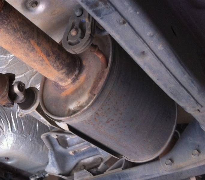

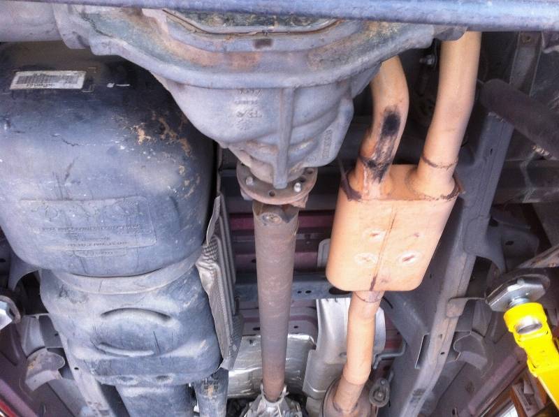

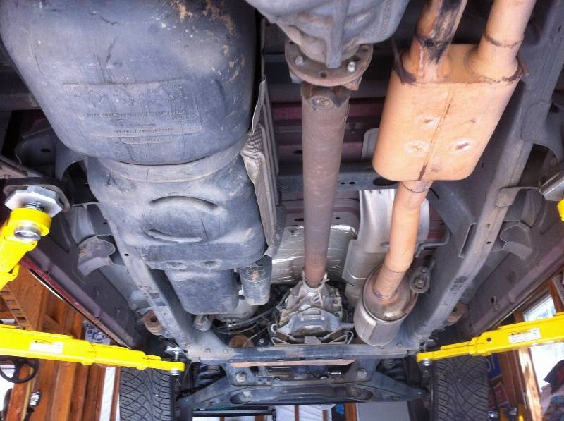

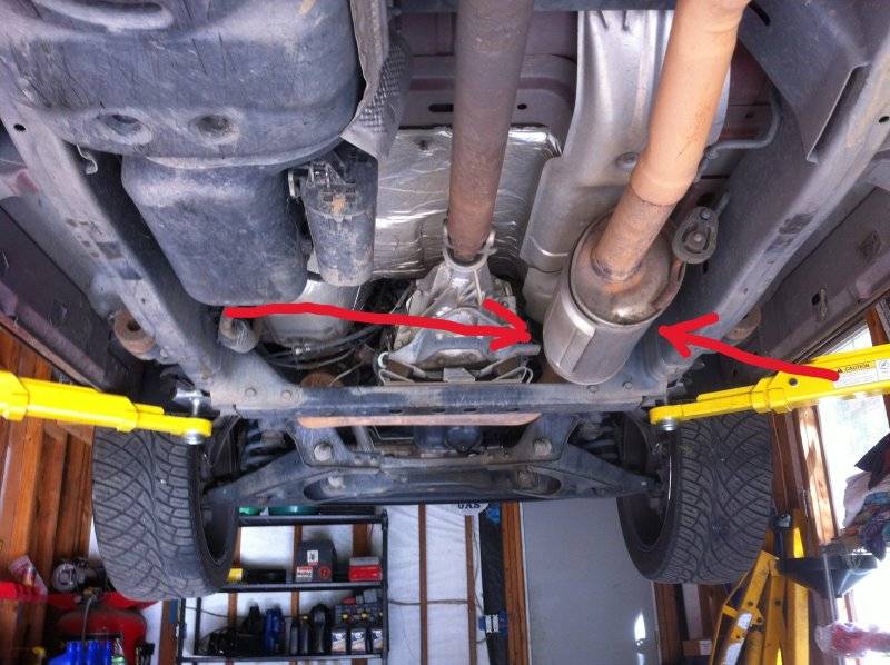

The truck has a converter just below each exhaust manifold, each side have an upstream and downstream O2 sensor. From there the left side meets the right to form a single pipe then into this thing. In stock form, from there it went through a 14" diameter barrel shaped muffler about 28" long, terminating at a small resonator just behind the right rear wheel. These trucks sounded like a sewing machine when new.

I would say not a converter. They are usually somewhat streamlined and since you say there are no 02 sensors on either side, not a converter. With those crimps, muffler or resonator.
I believe that’s called a filter.
Looks like a cat ,but it is not.
Yeah? To filter what? Filters get clogged and need replacement. Could it be there to slow exhaust flow so the converters are more efficient?
Diesel's run particulate filters. Don't think gas stuff did that. Greg, check on Rock Auto to see what's available for converters, mufflers, resonators. That might help ID what you have.

Look it up in your Factory Service Manual :poke:
:rofl::rofl::rofl:
Is it warm to touch after running and sitting a few so you won’t get burned by touching?
No, probably a resonator by the shape of it since single exhaust can have some irritating NVH to it.
Looks like a resonator to me. Catalytic converters need to be hot to work properly so they are usually closer to the exhaust manifolds.
A California noise thing, or a short box thing would be my guess.
