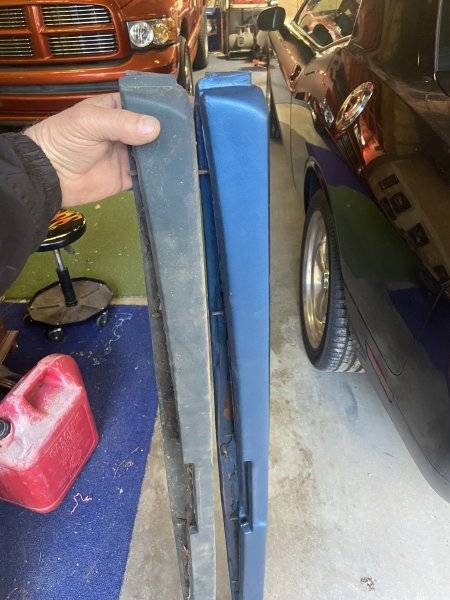

Both 53 year old cores that I have are the same length. I’m going to compare the new one to these tomorrow morning.

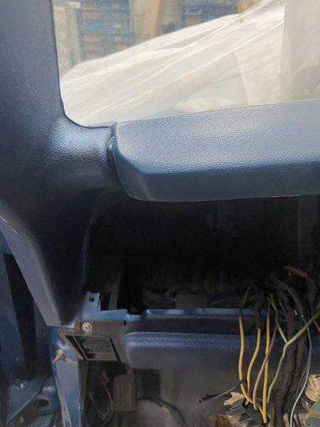

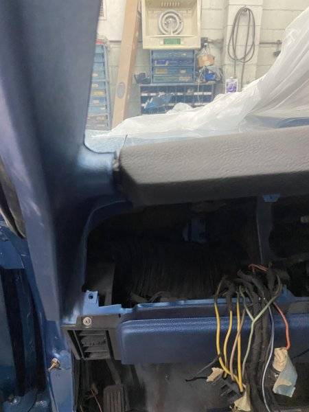

Drivers side looks good but the passenger side looks like sheeeet.
Short of the A pillar trim and the shape at the end of the pad is not the same as the A pillar trim.

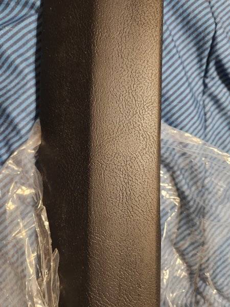

Bring yours over and let’s check it on my car. It pissed me off that the core wasn’t metal. I specifically asked twice.

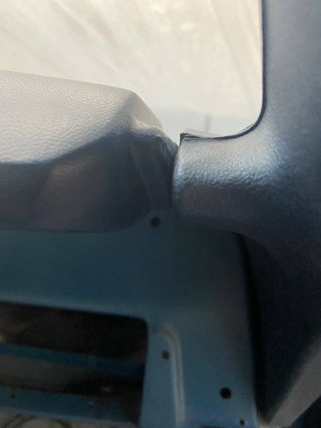

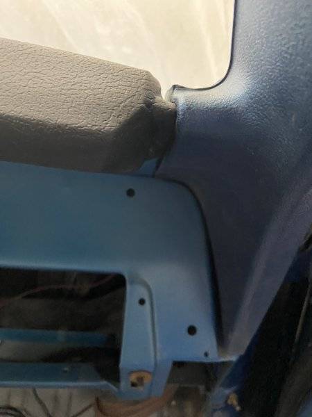

Ok guys, I tried @davek dash pad that he purchased from ABC Moparts for his 70 Charger on my 70 road runner and it fit perfect.
If I go with the black pad and dye it blue route, this may be an option.
Here are some pictures of the fit.
