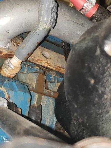

less than 1000 miles on the motor, and freeze plug cracked and leaking like crazy !
of course i have to pull the headers to get to it, and the Rona Run 2020 is less than a week away
Time to get to work !
I wonder if they got replaced when the heads were done.
I’ve seen it where sometimes they were...... and sometimes they weren’t.
It wouldn’t surprise me if it had a hole corroded through it.
For anything that uses a weak a/f mix, or no a/f....... best to use brass...... especially if it sits a lot.
Why does your coolant look so nasty?
Im going for slightly deeper plugs for my build, but If I were you....I’d check them all sir
yea, i plan on checking them all, everything was supposed to be new
