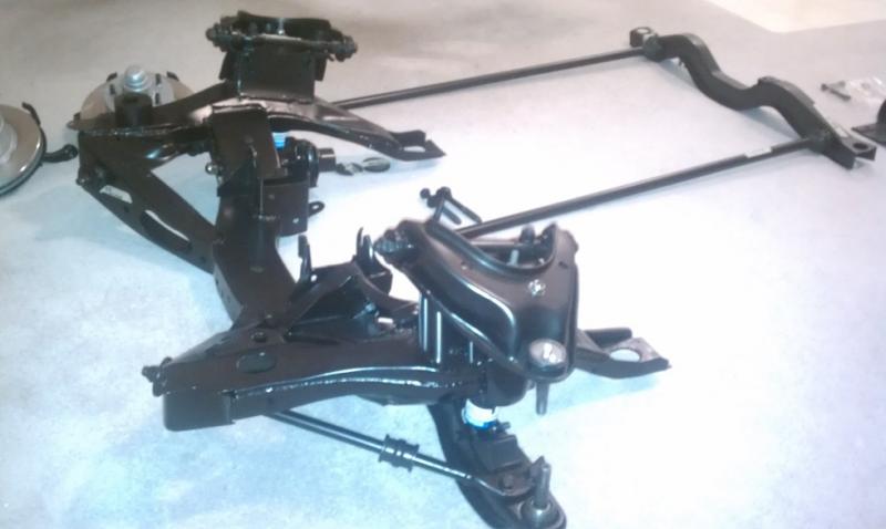

From what I could tell, the k-frame, sway bars, torsion bars were painted on my car. Far too much oil, grime, and rust to tell what else was painted or coated, so I just powder coated all of it.
Here is how it looked before I put it back in.
