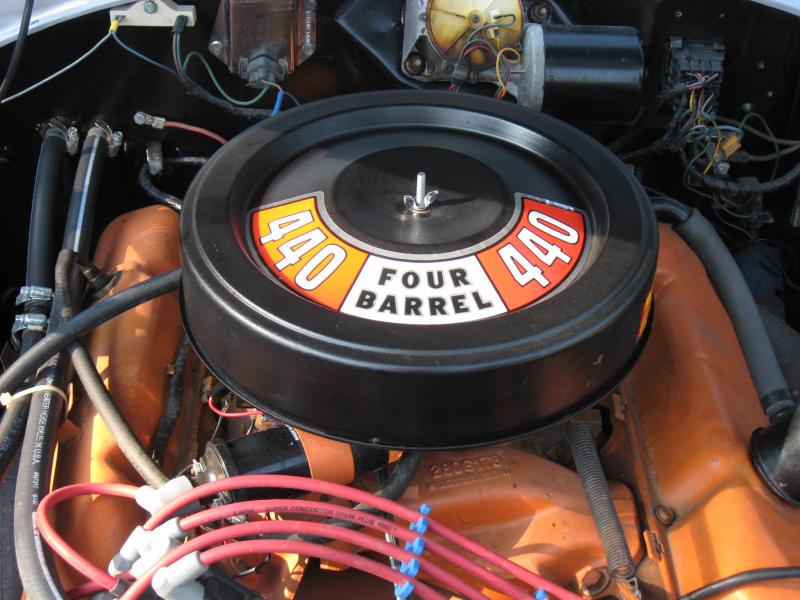

I'm running a 440 with a rpm intake and holley 750 in my 66 bel. I'm using a repro unsilenced breather I got from Mancini. I couldn't use a drop base breather because of the trans linkage and coil. I went down to my local auto parts store and looked thru a air filter book until I found the shortest filter that was the correct diameter. The breather barely fits but it looks great. I can get you the filter # if you need it.

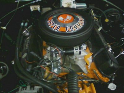

I have a super commando pin plate and the lid for an un-silenced air cleaner but no base plate.
Was worried about it sucking too much hot air.
I have a K&N filter lid in my parts stash too. The current drop base isn;t a factory part just a cheap unknown parts store one.

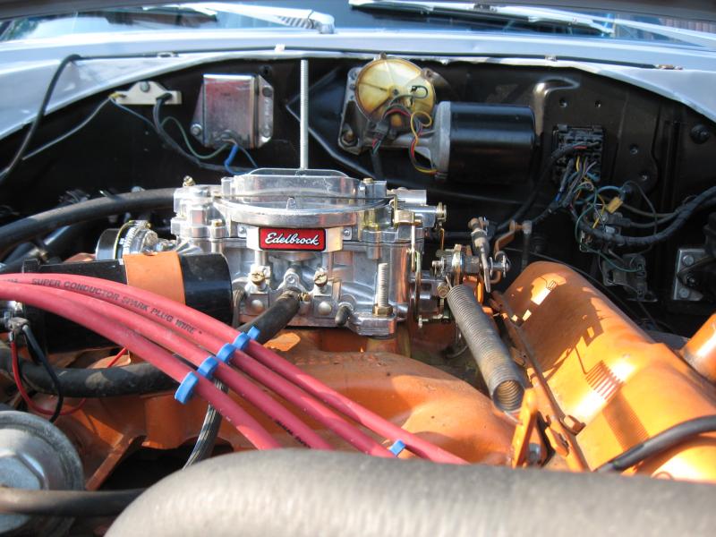

heres whats on my 66 Belvy II.. im not exacyly what it is originally from...but the car did not come with a 440. i had an eddy carb, but put a Holley on it which sits alot higher and i have no hitting issues
no pix of the holley on it yet but heres one with the eddy
The edelbrock rpm intake sets up a lot higher than the intake you have.
