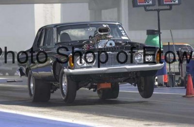

I went with SSBC,now can stop from over 130 MPH at the track without ANY issues:VB toast:
