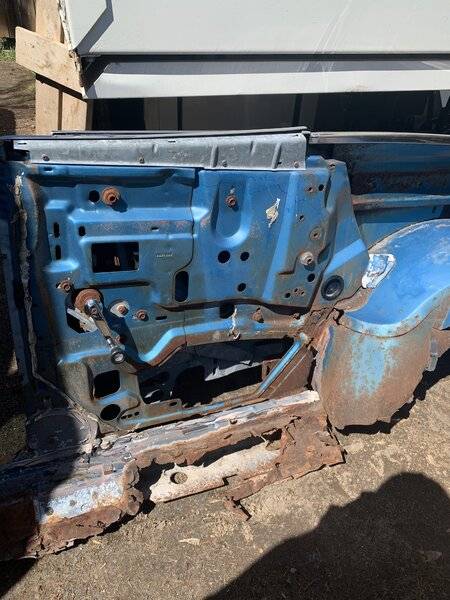

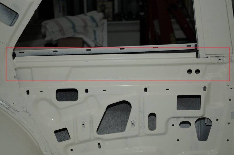

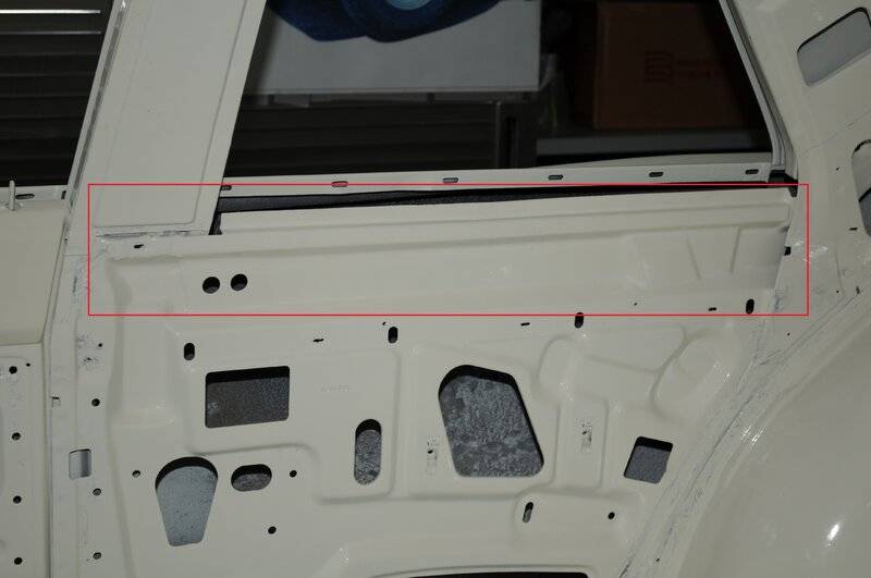

If anything. Is there a part that should be here? See pics

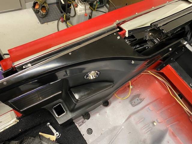

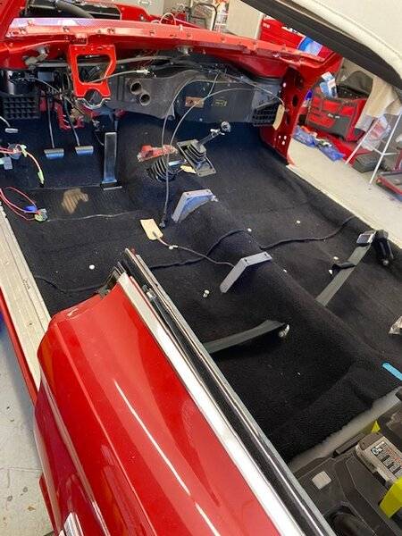

Hi Snook, I do not know if the Post is they same as the Convert, but on my convert, there is a steel piece that on the window side, holds the Window scraper. On the Interior side, it holds the Inside Quarter Panel Cover. Let me see if I can find a pic or two for you. More later, best, B.
Snook, I am sorry to say that I do not have a good pic. Perhaps someone else can help with that. Here is a pic of mine already installed on the Drivers side. You can see that I have already put on the Scraper. You can see then on the opposite side of the scraper that bare steel piece. It holds the Interior Panel. Best of luck. B.
One more pic that might help, if yours is like mine. It is a pic of the Interior Panel installed. If you look just beside the Scraper Chrome you will see three screws in the Interior Panel. Those go into that steel piece. On mine, the rear Interior Panel slides in Under the Chrome on the Window Scraper and then gets these three screws into this Steel Piece. Best, B.
Thanks for the effort but I can't tell from the pics.

On a 66/67 HT there is a sheet metal panel, bent to hook over the ledge up against the window.

Thanks guys, it's clear that I'm missing the pieces for both sides, now I just have to find them.

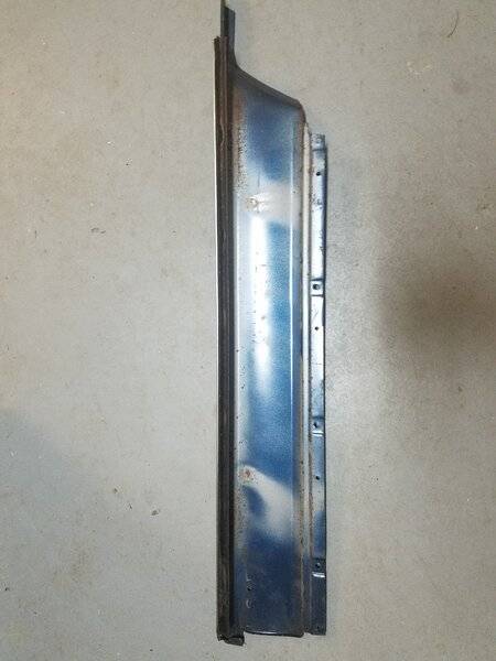

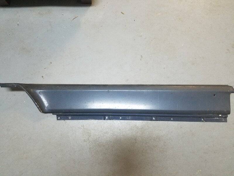

Here is what you are looking for. I have a spare pair...
EDIT: I looked at the op's pics and his car looks like a sedan. Mine are for a hardtop.
Installed...

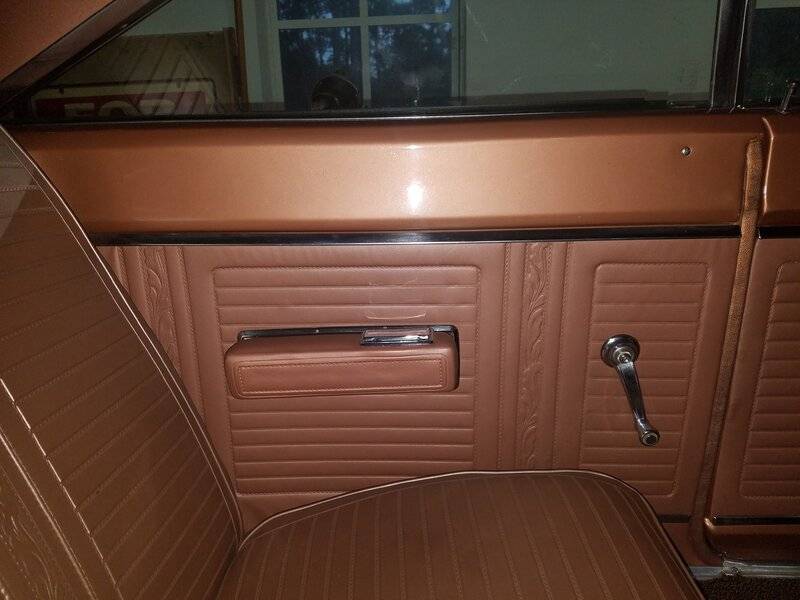

Thanks. Yup I have a post (sedan). A 4 door should be the same. Love that copper color.

FSM shows them for hardtops and sedans. Haven't checked the parts manual, but I would think that 4-dr would be different because that would be on the door.
Too bad mine aren't the right ones, I saw that you are just a little North of me. I'm in northern Palm Beach county. :)
I've got the FSM and blew right past that. DOH. Thanks! Yeah that would have worked out nice.
snook
4 door part would be the door.
2D HT part is different.
2D sedan part is gonna be likely as hard to find as a convertible part.
