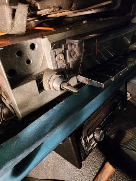

What am i missing to mount my radio in my 1966 Dodge Coronet. The only thing i have is the brass colored arm on the back of the radio.

Is there a tray or something I am missing that stops the radio from sliding around. As the title says I only thing I have to mount this radio is the brass colored arm on the back but the radio is moving around a lot when trying to put the dash back on and is sitting too low. I bought a replacement radio a few years ago as the original was long since gone but didn't feel like pulling it all out till recently since the odometer broke.

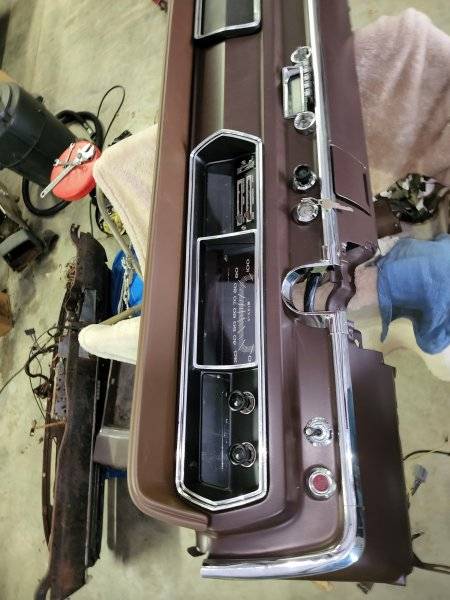

OK, has the dash been cut? The radio should slide in from the back of the dash and nuts on the control knobs hold it in place along with the front bezel. Then there is a bracket that attracts to the back of the radio to support it at the back.
Coronet radio mounts in the plastic gauge bezel up higher than a Plymouth. The heater control panel also holds the radio in place.
Where are your heater controls and plastic instrument cluster bezel?
The brass colored arm, it it round with flattened ends for the hardware to go through? Ot is it a flat metal strap?
Take those nuts off the radio stems, they go on after the radio is through the dash bezel.

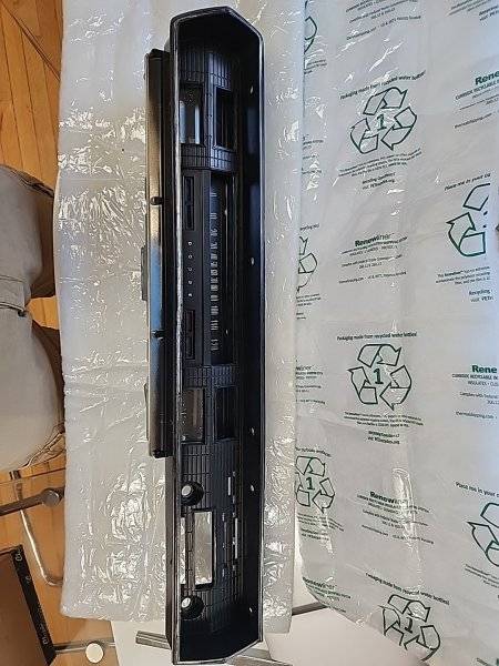

I got a used instrument panel so it is not cut anymore the previous owner did a horrendous job hacking out enough plastic to fit an 8 track in the mid 70s. So if I'm understanding you correctly the support arm keeps it up and the tuner knobs keep it locked into the front of the bezel. There's nothing else?

Got it thank you I will take those nuts off. So the radio goes in after I've got the dash put it then obviously. I assumed the opposite and spent more time than i want to admit trying to get this to go in. Finally gave in and now we are here.The The arm is like the one here from an ebay listing.

Your rear arm is correct for your coronet.
