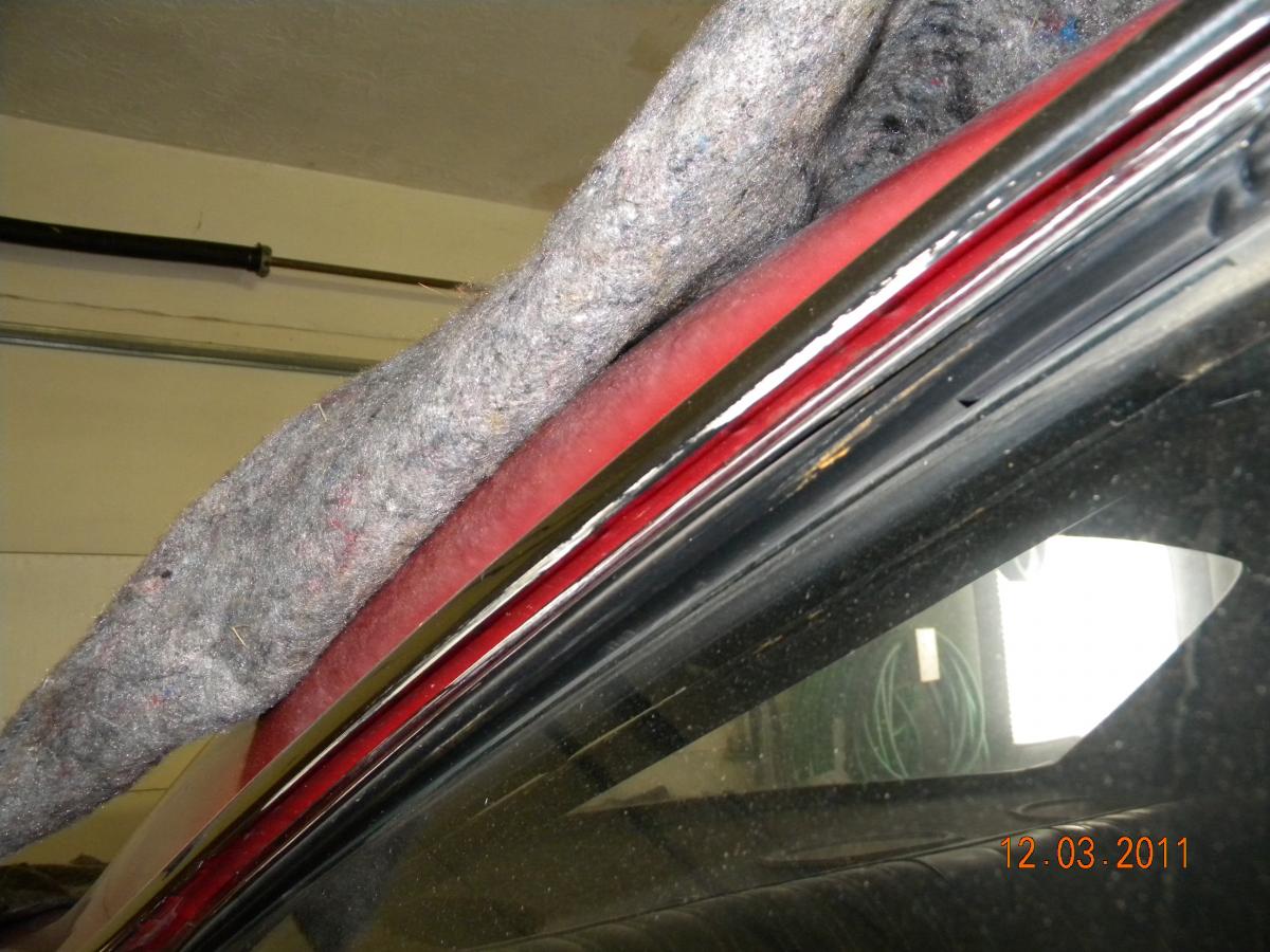

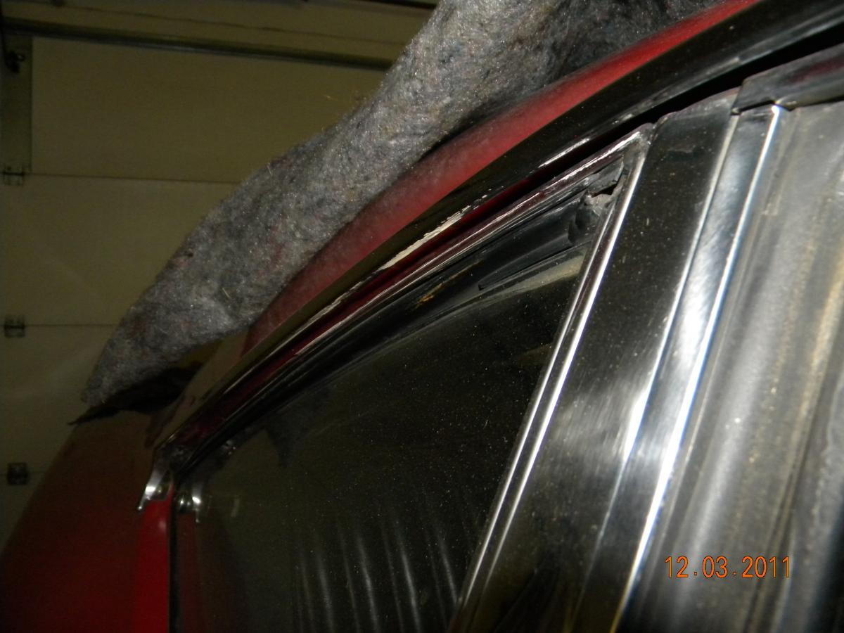

68 Superbee 1/4 popout windows have a big gap and it seems that I am missing something. Any help would be great. Is there something that goes there. I have asked this before but finally got some pictures to see if this helps understand what problem I am having. I did not remove these as me dad did years ago and I am trying to put it back together. He was giving less than 6 months so just really trying to get it on the road for a couple of rides. He does not remember anything being there but that was long ago. If needed I will just go without them installed as long as he gets that last ride. Thanks guys
Sorry pictures did not load trying this again

Milt73, it looks like your missing another piece of stainless that goes from the drip rail to the inside and acts as a retainer for the weatherseal/gasket. The door glass has the same piece.
As far as I know these are original to the car but I don't know if my dad ever replaced them for any reason.
Ok that helps as I was going crazy looking at different pictures of cars but never really being able to see anything. If anyone had these parts let me know. Thanks

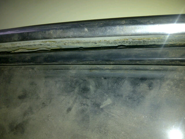

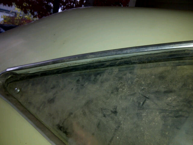

Unmolested 1/4 windows
Mine has a stainless steel(?) filler piece above the main weatherstrip.Plus the drip rail
