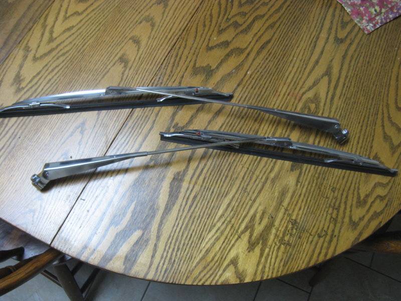

Thanks for the replies! I thought they were incorrect. Funny though that the wiper blades are the airfoil style in satin /matte silver same as the arms and have 3 red buttons on each. I will try and post a pic tomorrow. Thanks again
Air foil wipers were available in B bodies in 1966, and 1967. 66 chrome, 67 satin I think compliments of Mr Nader.

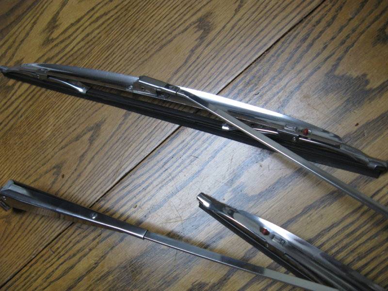

Also standard on 64 models...Here is an Nos pair I picked last year for my 64.
