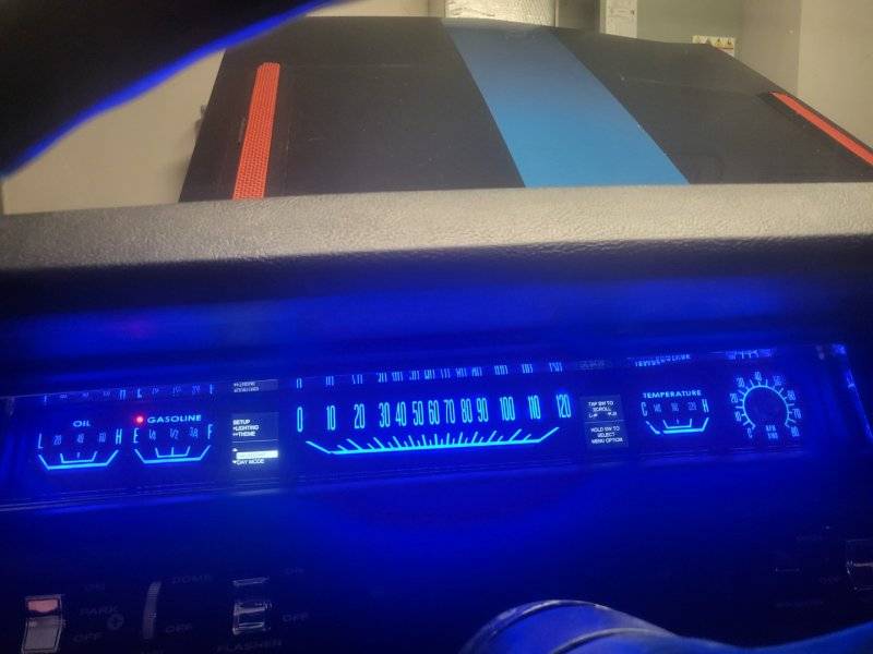

That's where I got mine, affordable street rods. When I ordered mine there were two in stock and I took one, I think you got the last one. I installed it and love it! I took my time installing and it wasn't that bad. I love all the information you can get from it and looks stock. I'm glad I went with it instead of buying a restored one, expensive but well worth it.
I went with Dakota Digital for my 1970 RR. I still have the original cluster, however the Digital solved a number of issues. If it's not an "original" car or an exact clone, new technology makes driving a 54 year old car more fun.
Can you post some pics of your new dash?
