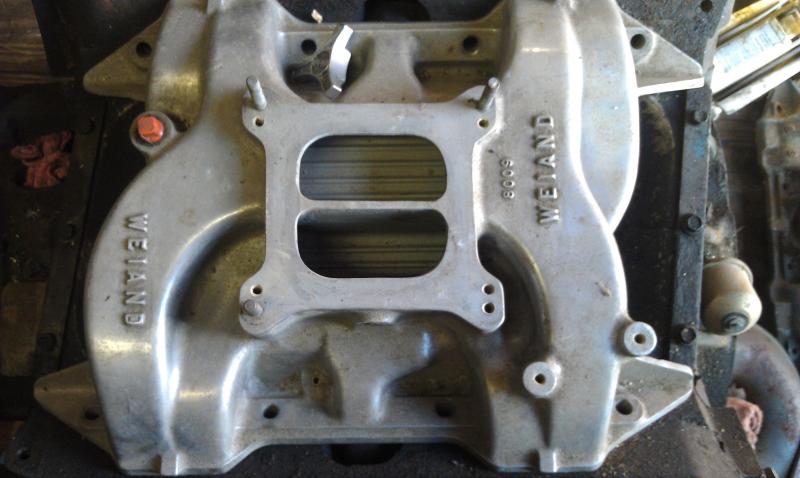

Hey, I have similar set ups in 3 440's. All using the 6 pack pistons you have here. Dump that Weiand Dual plane. 40 yr old outdated. Go with a Performer RPM 440 intake. You will see a difference immediately with that intake. Regarding the camshaft, I agree that Racer Brown is awesome. I use his 300 duration/ .520 lift hydraulic in my 71 Cuda 440 (6 pack pistons) and run 11.6. However, in my 87 440 Dodge w150 I run a Lunati "Voodoo" and took out a Comp Cams..What a difference that made! I picked up 3 mpg with similar specs (the 256 Voodoo cam; .475 lift)

Just my 2 cents from experience..and using those 6 pack pistons. A Thermoquad intake is equal or better than that Weiand you have.:angry9:
the reason I planned on using the weiand intake was because it came with my 440 when I bought it. if it isnt going to work for me I wont hesitate to replace it and put it up for sale it was kind of a freebie so Im not in love with it.

How sure are you about that intake number? Could it be 8008? If it is, that's for a low deck. In either case, it's better than a stock intake. If it's a tall deck intake, use it. It will work fine.
This is the intake intake.jpg thankyou for all the help guys I definitely need it when it comes to this stuff as I have very little knowledge about this topic. I do realize that this is a very subjective topic and I am finding that there are alot of different ways to achieve certain goals its actually a bit intimidating lol. As far as my goals go they are fairly simple i think lol this is my first mopar and I love it and I drive it almost every day when there isn't snow on the ground that is. That being said reliability driveability are important and having some extra power is great too. Am I going to be drag racing at the nearest track on the weekends probably not but I would hate to put myself in a position to where upgrading later on to make it even more powerful is difficult or impossible. Maybe my goals need to be adjusted a bit lol I'm not sure that's why I rely on the experience and knowledge from the guys who have been there before.

I do actually have a stock iron intake as well that came with my engine only chose the weiand as it seemed the obvious choice to me as far as stock cam goes my 440 is a 78 and was out of a motor home so the stock cam from what i've read is pretty much useless so I just packed it away in the not sure what to do with pile lol.
That's a great intake. Use it.

Hi, I still recommend the Performer RPM 440 intake. The best Chrysler RB factory intake for single 4bbl is the Thermoquad. I ran a stock class for years with this intake, 6 pack pistons, Carter AVS on my 71 Cuda. Consistent 11.89's. I ran 2/10's better with that intake than a 1970 variety and also the old m01 dual plane. They do not flow as well. However the Thermoquad intake had the center meat all taken out so it was a square opening. Milled the wall to 5/8 inch. Used and adapter with the old 1971 AVS carb. Great intake as far as factory heavy iron goes. But, they are very heavy. I run 6 pack pistons in my 87 w150 440. I was running a thermoquad intake (1972-78) and took it off in favor of the Peformer RPM. There was a noticeable difference in performance. It scooted much better out of the hold. This was prior to taking out the comp cam and putting in the Voodoo. But, you need more hood clearance for the Performer RPM 440. They sit taller. Best dual purpose intake out there today. Read the Mopar magazine article on intakes. They did 11. I still have the mag. Another good intake is the Holley Street Dominator. It makes more torque than the factory pieces as well. And it sits lower. Your heads are fine with those pistons. The extra lift of of the Voodoo cams is beneficial. It is a modern grind. Voodoo 268. Not true that stock heads quit flowing at .450 lift. They keep flowing up around .520-.550... They respond to this type of cam, especially with the higher compression pistons you are using. the Summit cams are old designs and are not impressive.old, slow ramps. You won't like it as much. New Voodoo and Xtreme energy cams take advantage of lobe ramp technology. This cam is good for 20 hp over a typical old school .455 lift camshaft. Anymore than 268 cams and you need a looser converter as well. Cam will work well with 323 gears. I am telling what I know based on my own tests with this stuff. I am always looking to go faster, get more fuel economy , etc. I can only advise from direct experience. I port my own heads and drag race as well. I am only telling what has worked for me. My friends have used the summit cams and their are much better cams out there...
