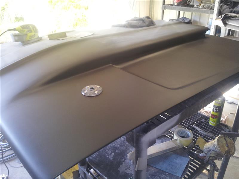

thanks meep , was also told to go a open by damon Kuhn as he also said with a big motor you will want more air/fuel going in from both sides of carb. my main reasoning with a 2' was the reverse cowl hood I put on will allow me to lift my massive hemi air cleaner into the cowl to receive the cold air at the base of the windscreen while sealing the base to the bottom of the hood and blocking off all hot air.

Did he know your running a cowl hood?
thanks nomax, yeh I told him.
heres a pic
