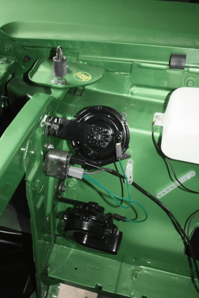

That’s where it goes on a 70 b body.
It's not here?
Here’s the horn relay on 70 Charger, right underneath the headlight doors relay (Circled).

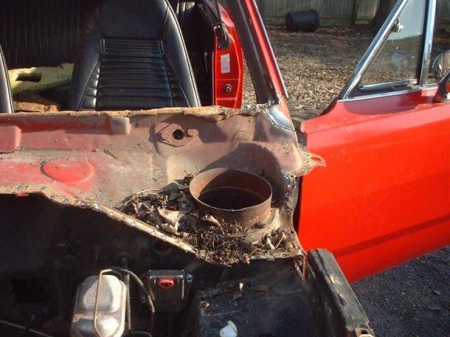

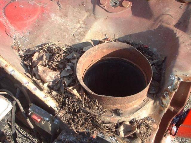

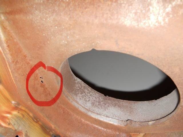

I don’t know if this helps but on my 74 Charger the drivers side leaked and puddled up on the floor. When I had a new windshield installed, there was a rust hole that was below the windshield gasket area that was causing the leak. The installer sealed it with the windshield goop and no more leaks.
My car only has the fresh air intake on the passenger side and it was not leaking and looked good. No more puddles since sealing the hole. It wasn’t very big but sure soaked things. It was hidden under all the accumulated dirt and debris and partly covered by the fender where it meets at the hood and door area.
