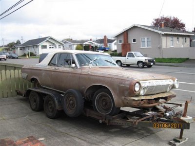

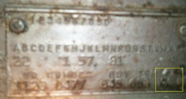

what color is my new car? data plate
Pic
645= Dodge V8, Polara 500, convertible
653= interior code = vinyl bucket seats. tan (?) in color
YY = metallic brown
thanks, and in between the chrome in back, the inlay color appears to be a highlighter silver but its faded. That inlay won't be another code on the data plate?
