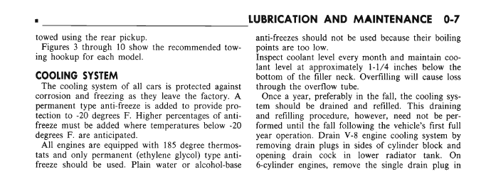

Many Mopars were factory equipped with 185 degree thermostats, not available in the aftermarket. Seems like the 185 would be a good compromise if you could find one. From page 0-7 of 1972 Plymouth Factory Service Manual:
