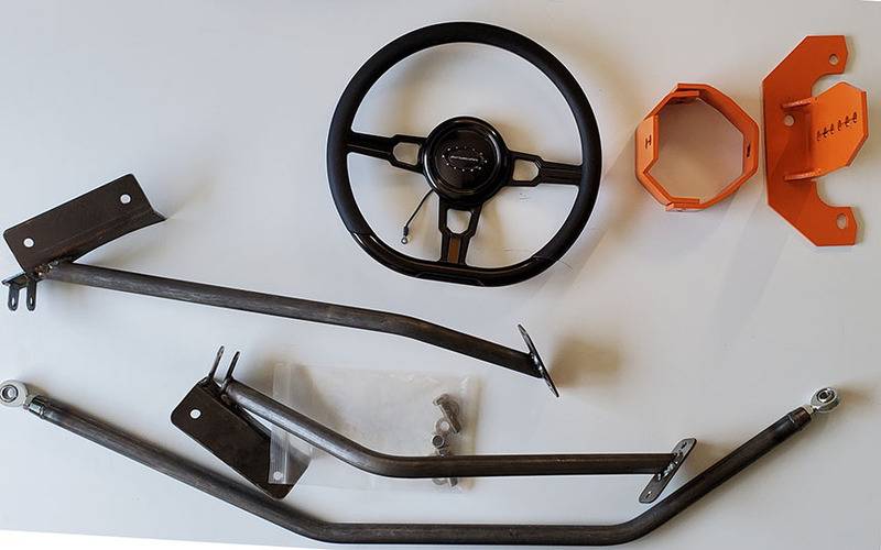

Yet more parts for the next big round of upgrades.
Billet Specialties half wrap steering wheel. Flaming river adapter and steering column on the way.
U.S. Car tool driveshaft loop.
XV Racing engine bay brace which will require some messaging to get in place.. this will add more support until I can install the inner fender brace.

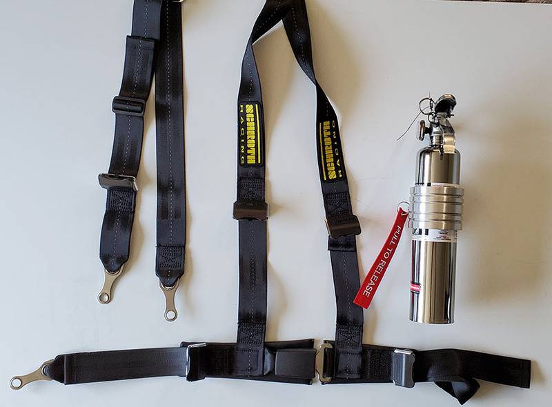

Schroth Rallye 4 harness.
H3R HalGuard Fire extinguisher in chrome with hold down.

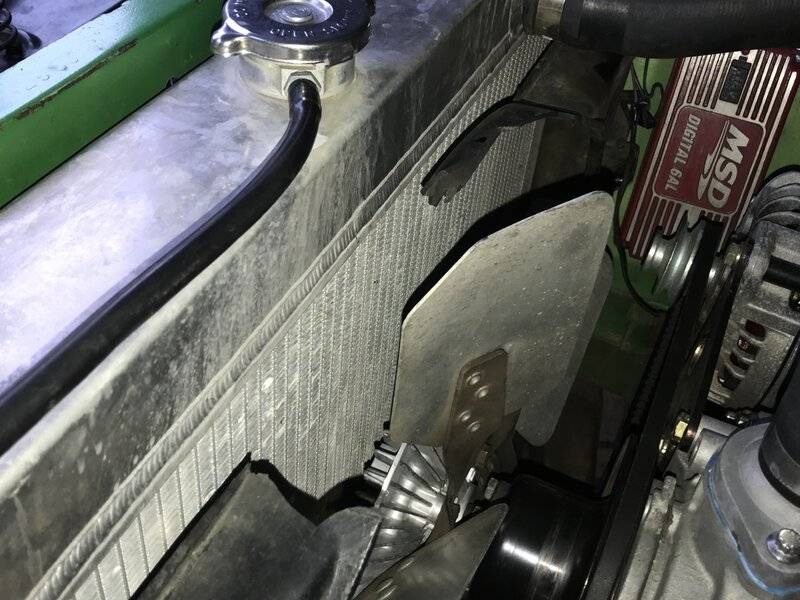

I got my fan shroud & valve cover gaskets.

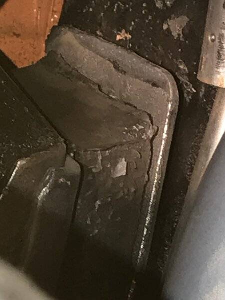

I recurved the distributor, found a lot more power, mashed the gas after a rolling start & tore my indestructable motor mount in half while frying the tires

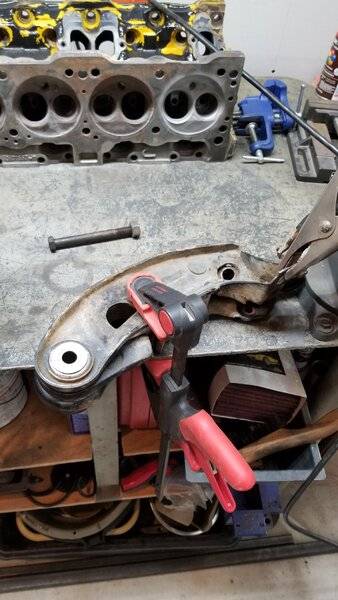

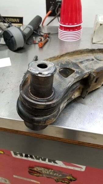

We pressed the bushings out of my buddies 67 GTX lower control arms (LCAs).
OMG I remember hacking out the outer portion of the bushing for hours when I restored my Road Runner. What a pain in the butt! Well, my buddy saw a video where some guy welded a washer to the bushing and pressed it out from the back. We decided to try it and I HIGHLY recommend this method - worked great!
Find a thick washer a bit smaller in diameter so the weld you put on it will weld the washer to the bushing and not to the LCA.
Then simply weld the washer on and press out the bushing from the back! Works like a charm!

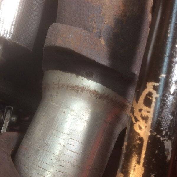

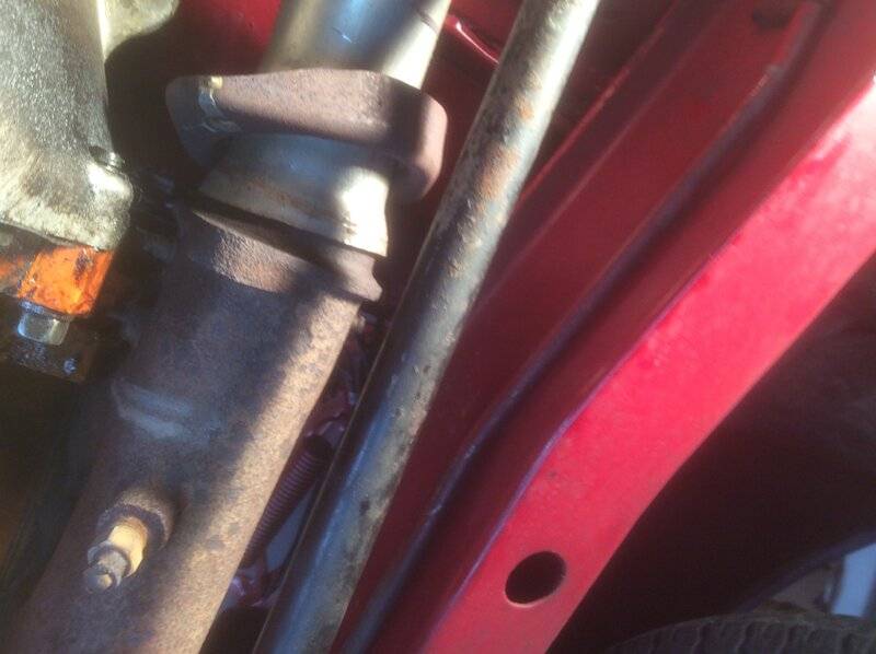

Crawled under Satellite to look for exhaust leak. Flares on pipe weren't to good, pipe looks like it wasn't cut right. Flanges were bolted even but you can see on pipe doesn't look right. Will check for gaps around flares, really don't what to dump $600/$700 on a H-pipe. Going to push pipe off exhaust manifolds and make sure they're clean. When I bolt it will be try put flanges to a better location on manifolds.

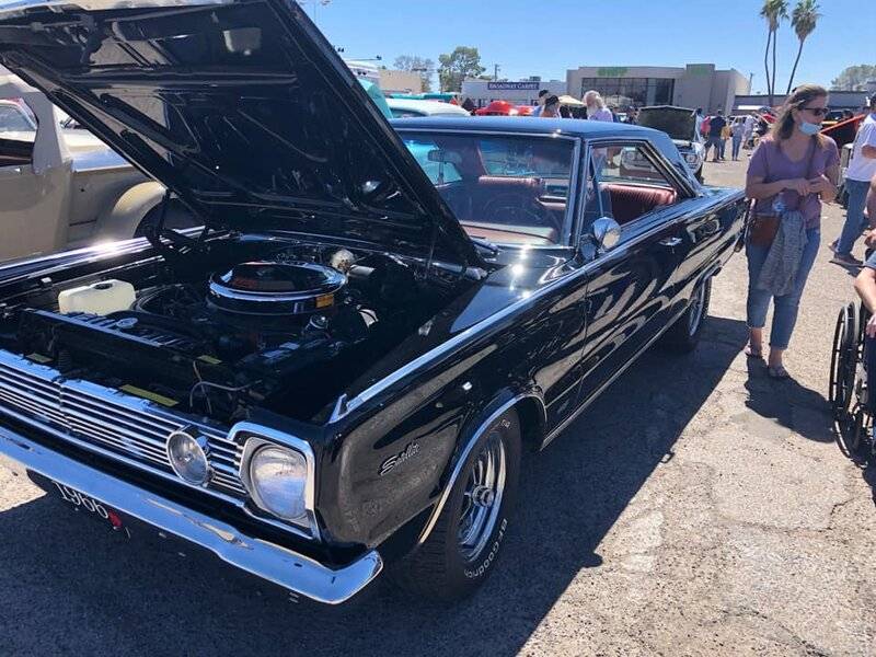

Yesterday took the Satellite to a local show near me.
Car got A LOT of comments , lots of pictures taken of it . And even sparked some really good conversations thru-out the day
Was a good car day .
