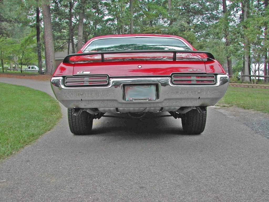

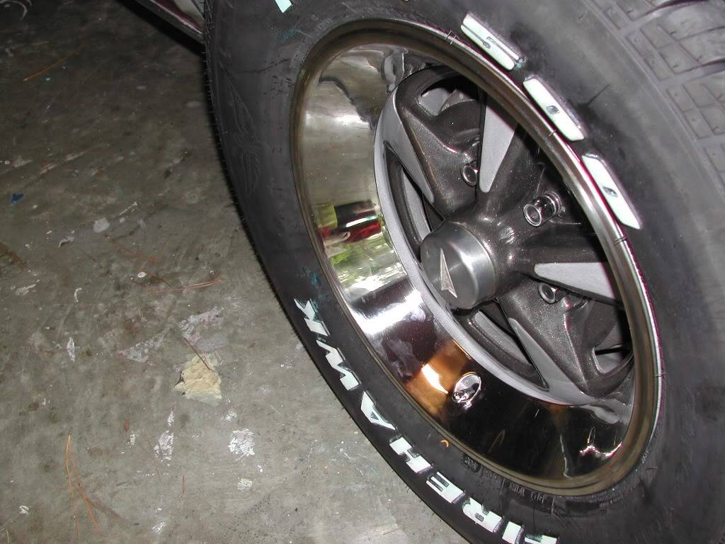

275's seem to fit the rear of the RR's quite well. But unless they are on an 8" rim, they kinda look like balloons.
you should see them on 15x7s!
if this is not old school I don't know what is
15x7.
275s used to be listed by a lot of tire manfacturers as ok for 7 inch.
Now almost all I think list for 7.5 minimum rim.
But guys have been running 275s on 7 inch rims for as long as drunk, fat chicks have been easy prey for high school guys at proms.
