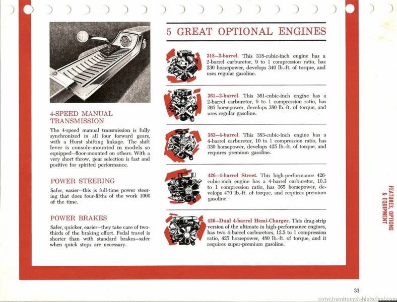

225,318,361,383,426W,426H, No Max Wedge in 65. Late 64 they went to the 426 Hemi.
The 426 Wedge was a RB engine single 4 barrel rated at 365 HP.

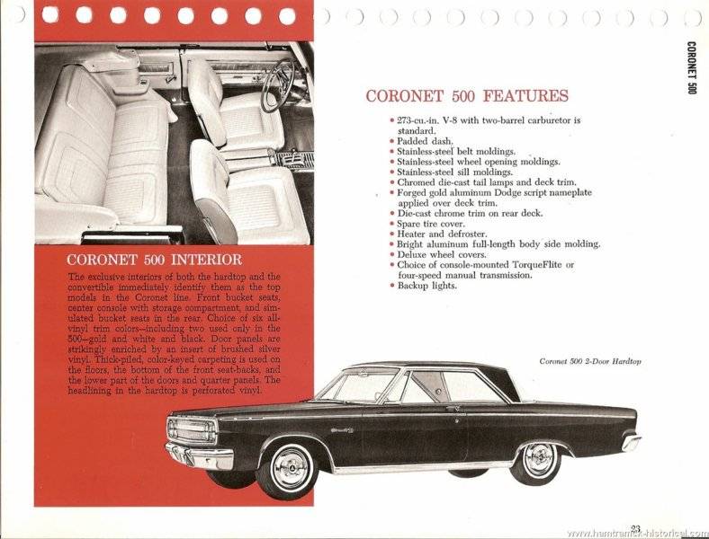

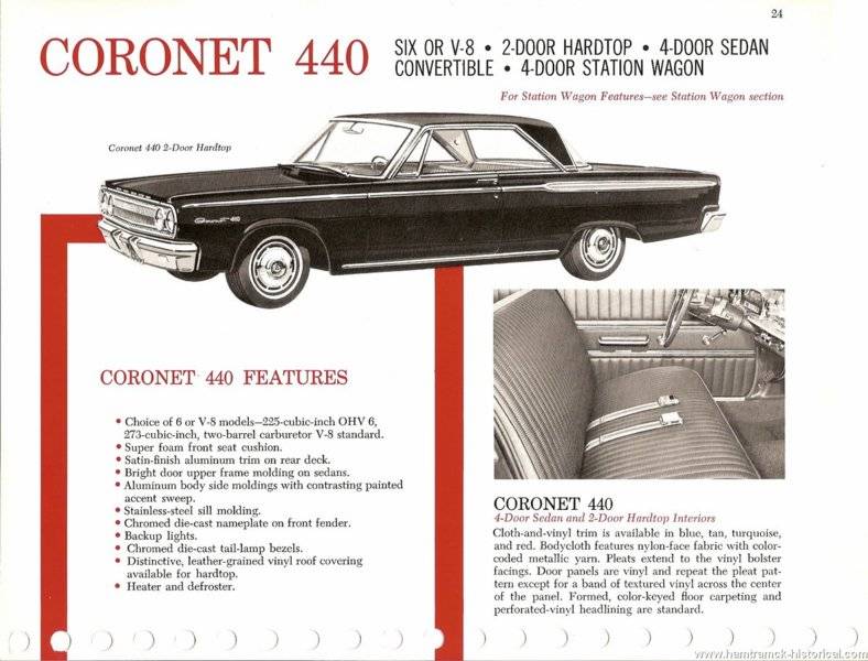

Don't forget about the 273.
Dang ! I looked at that several times saying to myself "It's just not right." Thanks for catching it M&M !
I can’t even remember 273’s back then(?). I do remember test-driving a 4-spd 2-door 426W, almost pulled the trigger but then the Bee’s came out.
Actually all 426 Hemi's race and street were all rated at 425 hp. So was all three stage's of the 13.5 and 12.5 comp 426 Max Wedges. If I had a 65 I would like to build a killer stroker version of the 426 street wedge using the big chrome air cleaner and all. Heck you could figure how to fit a Dominator under that air cleaner. Ron
