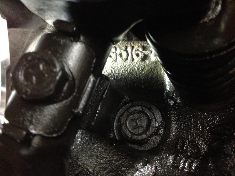

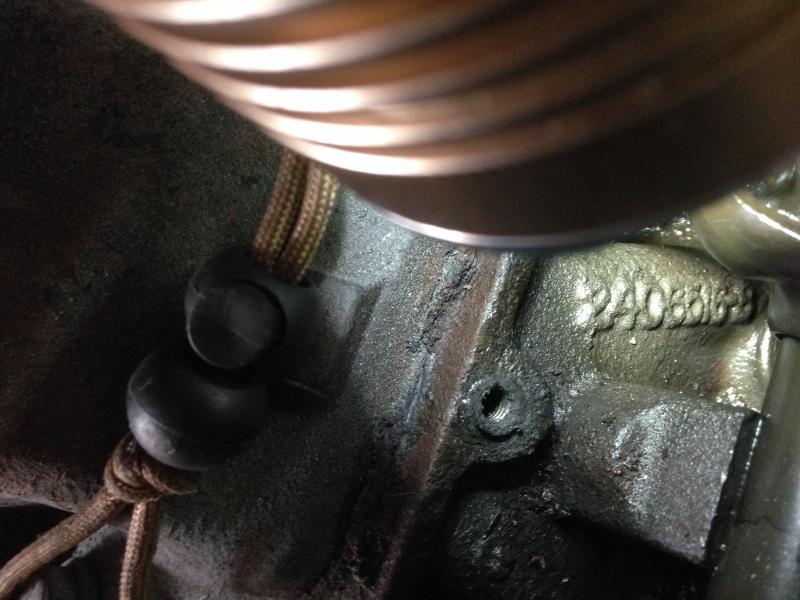

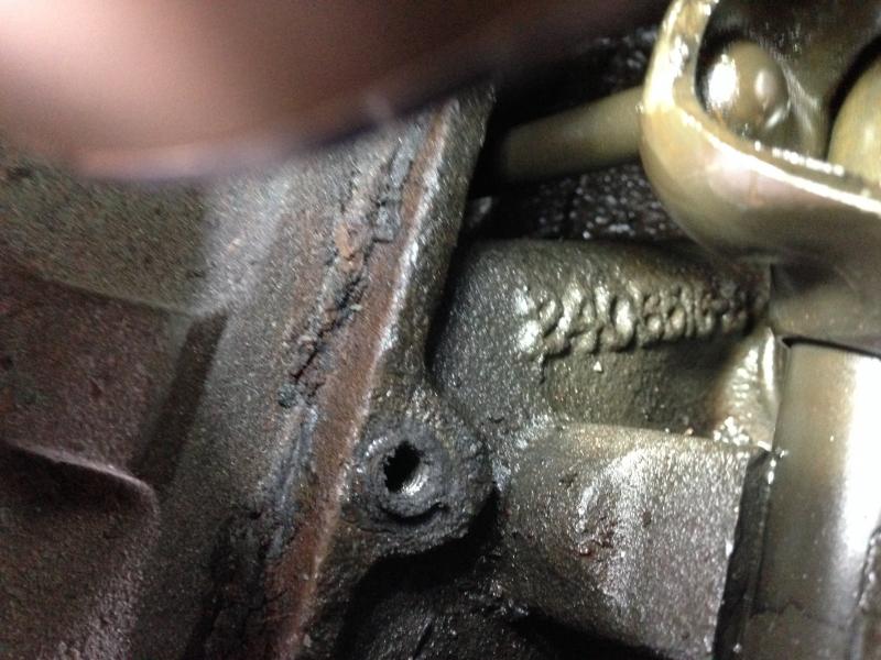

After almost standing on my head and a number of contortions that I didn't think my body was capable of and an untold number of photos, I finally got a legible shot of the number.
The number is 2406516 not 2406518. As was said by 69Bee I believe.
On that one side it sure looked like ***518. But, after a while it's almost like looking at clouds, you either can see it or you can't.
Thanks for the info everyone.
