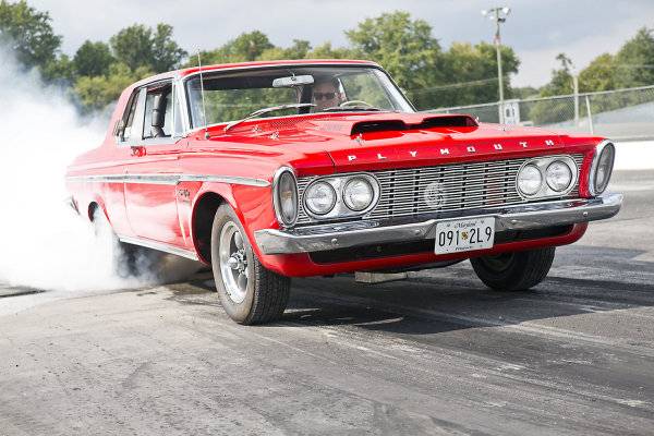

i have not raced for about 10 yrs i have a all steel 63 plymouth savoy with a 426 max wedge it made 510hp 508 tq at the crank has a 10in converter 3500 stall trick 727 straight cut gears manuel valve body no alum parts 4:10 sure grip 90/10 front shocks super stock springs with rancho 5way adj rear shocks with 275/60 15 m/t et street tires i would say about 3750-3800pounds with me in it Thanks View attachment 555671 View attachment 555671 View attachment 555671 View attachment 555672
11.3-11.4@114-116 if the converter is loose enough and it hooks. My bet is the converter is to tight. MPH will tell you.
Doug
Almost identical setup as I had in my GTX.
3690 lbs.
It went 11.20 after some tweaking and a 9.5 4200 converter swap

I would guess low to mid 12’s, but it could run a high 11 too. When I was at that power level I was mid upper 12’s but I was also 600 pounds heavier then.
I'd wild *** guess mid 12's down to maybe mid-hi 11's

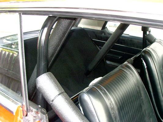

My 63 weighs 3725 lbs. I added a 6point rollbar and frame connectors. Its full interior other then back seat which I had planned to put back in but after I put the rollbar in I could not fit the rear seat back in the car. So I am 61 and most of my friends are around my age and I figure we are not climbing over the bar to get back there anyway so I left the rear seat out. Ron
You can see in this pic how I put carpet over it after I put a metal plate over where the rear seat back went since I have my battery in the trunk. Ron
