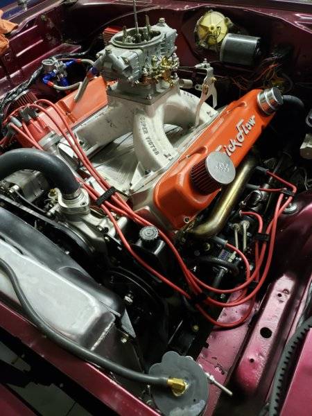

I'm running a 512 in a 66 Coronet. 12.4 compression, hughes 268/272 solid cam, hughes 1.6 rockers, trick flow 270 heads, Super victor intake and a small 850 carb. 2in TTI headers, 3in exhaust. View attachment 902351 Ran a 10.46 at 129 first day out. Use pump gas for street and mix 110 50/50 at track. Very steetable and fast motor. Can't wait to put the 1050 dominator on it. Chassis is pretty much same as yours, Calvert everything in rear 90/10 in front. 3.90 gears, 4200 stall, 30in tall tires. What a blast!
Use an HVH 4150 to 4500 carb adapter and mount up a Holley 1050 Dominator SP (from summit at $811 brand new) and you will pick up a couple 10ths.

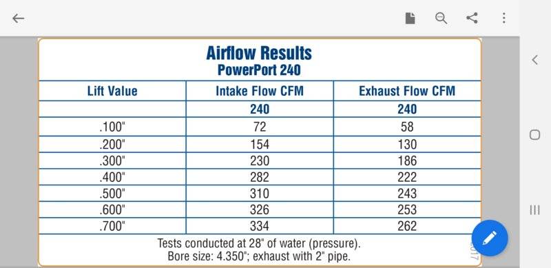

So I'm thinking if I can build or find a head that flows 340-350 cfm at .650 lift that should be a good spot to be for a 650 HP low deck stroker street strip motor.
I'm definently impressed by the trickflows. I run the 270s, they're a max wedge type head. Flow great right out of the box and are pretty reasonably priced.
My only decision to make when the time finally comes is TF 240s or 270s. I am going to use an aftermarket aluminum block, so my displacement is going to be larger than I had originally planned.
At 541, it's going to be hard not to go with the 270s.

You can get your RPM heads ported but I'd use the 240 Trick Flow heads if it was in the budget.
Ran that cam in my Cuda with Indy Sr'cnc ported to max medge by MCH. Shifted at 6300 and ran a best of low 10 teens with a holley 950. Needed a Dominator.
I will say if you are running Hughes springs to keep an eye on them. Mine were dead at 150 runs and was running into valve float at only 6300.
