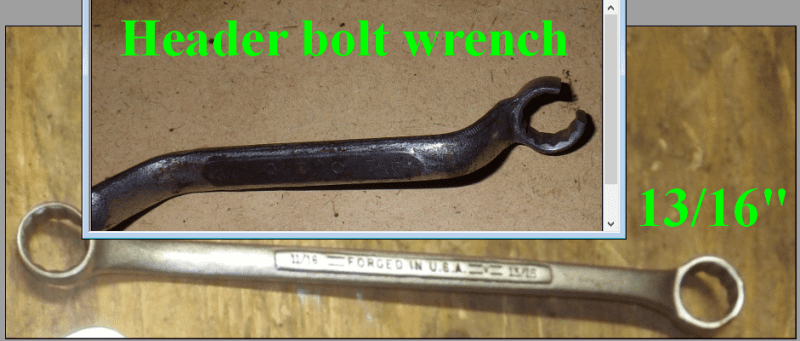

Maybe something like my cut-out header bolt wrench on a 13/16" box?...........
Or shorten up a thin wall 13/16" 12 point socket just to break it loose? A short plug socket W/O the rubber insert?

I found one of my dad's wrenchs from like 1800's. I looked thin, so I tried it and it works!!

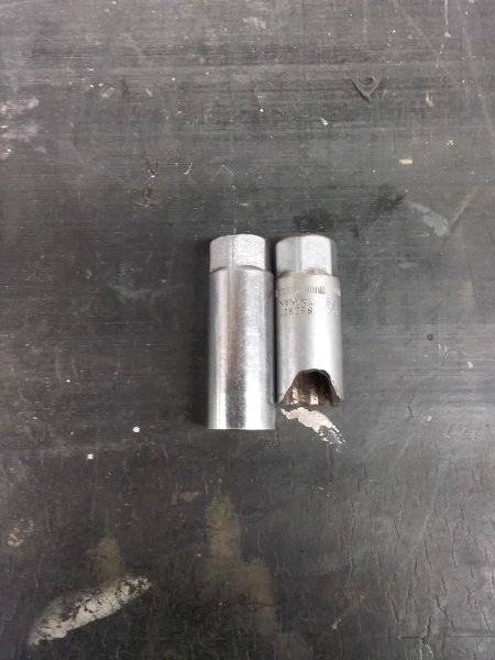

Now on my sons pos chebby 3rd gen camaro I have to use a custom socket I made. It has part of the side cut out
I'll post a pic in a minute, got to grab a beer first. Its Friday
