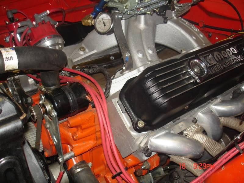

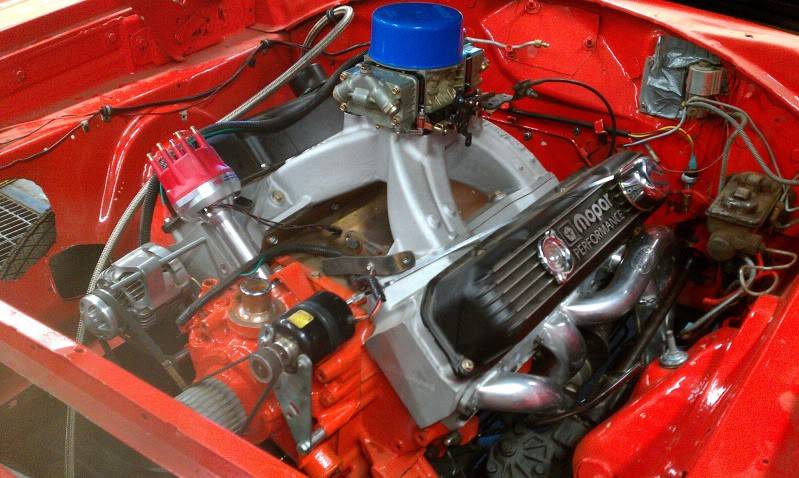

I have Indy 440 EZ heads on an RB in my 67 Belvedere. Using solid Moroso engine mounts, no motor plate or midplate. Anyone know what headers will work? I know Hooker 5209 will not.
I used header#5209.Had to do a little modifaction on #7.Cut about 1/4" off and rewelded,#8 I had to dimple.
I Whined a little when cut her,but I had to do her
See post in Racer Hang out...
