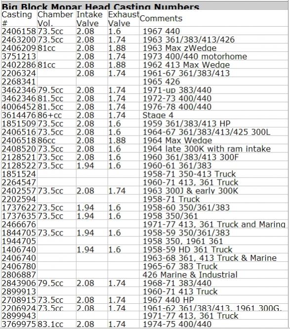

Hi guys,
I'm looking at a 69' 383 which claims to have later heads on it and i'm just wondering what they could be. All that comes to mind is 452?
Could be a number of heads;
The 452 heads are do have the induction hardened valve seats
That's a great chart !! all in 1
I think see a couple of typos. Isn't 67 440 2780915? Also how is a 2406158 a 67 440 head? Maybe I'm missing something?
I think your right... the chart has the 915 as an HP for a 67 440 but I thought the 915 were an earlier year... I think there is a casting number missing for 1968 as well, a one year only listed 440 head used only on a 383... When I get home tonight I'll look. I pulled this off a page from a search on the net so I cant say much for it's accuracy.
