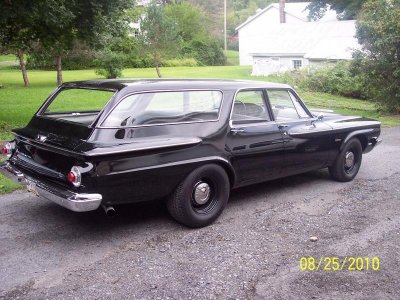

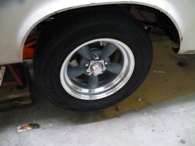

I decided to go with Cragar SS Wheels all the way around. I am going to keep the original steels as a back up.
Saw some pics of other 62's with Cragars and really like the look.

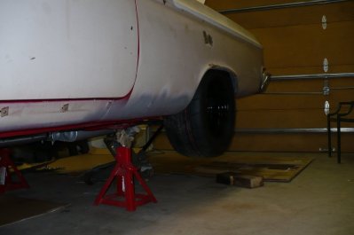

I can only get rear backspacing on Cragars at 4.25"on 15x8. I'm a bit worried about getting the tire size I wanted at 275/60/15 to fit. I might have to go 265/60/15. I'm not a big gambler.

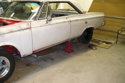

If you get the Cragar G/T wheels, you can get the 4.5" backspacing. That's what I put on my '65 with 275/60 r15s and they fit fine. Fronts are 15x7 with 215/70 r15s.
Kid was correct. Went with the Cragars. I am satisfied with my choice. And I am glad I did the center spinner. Makes it feel a little period correct.
