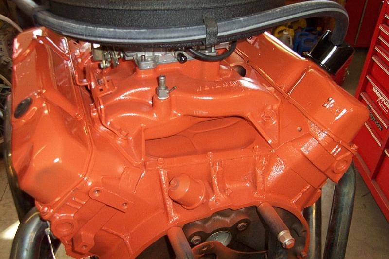

Correct and if is a 70 BB Charger it should have the dome type for a gauge. The socket is for the small unit for the light. Dome unit takes a 1/2" ,I think, open end wrench.
