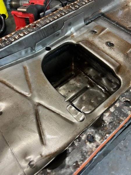

Before installing everything dry tonight, here's a look into the aluminum pans sump trap door. (top photo)
The horizontal ledge splash baffles by the top don't extend outward as much as the ones on the steel pan, so it must be part of the oil flow plan. (bottom photo)
