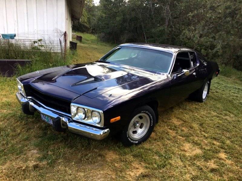

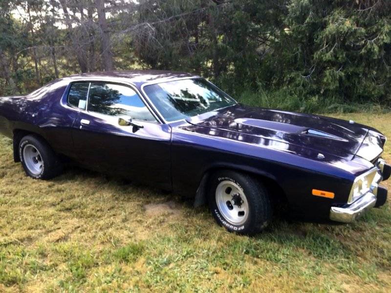

Hello Fellow Racers,
I have a '73 Ply Road Runner I would love to race. I need your help in choosing the right carb for my bird. This is the low down on my Road Runner-
LA 360 30 over
Erson Cam E4200421- Hot Street ET Bracket Cam - Broad power range/strong top end
Valve Lift .472 Duration 296 Hi Flow IH 106 L/C
340 X Heads 1968 model production fresh out of the machine shop
RPM Performer Edelbrock Intake Manifold
570 CFM Dual Feed Single Pump Auto Choke
727 Torque Flight Stage 2 full manual valve body w/3000 RPM Torque Converter
3rd Member is Stock 321 / 9-1/4 (soon to be replaced with ford 9" 386 posi )
I also run on public roads occasionally.
Any and all suggestions on picking out the right carb is great appreciated.
Thanks again in advance :))))))
