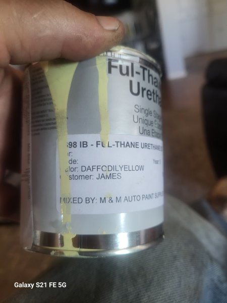

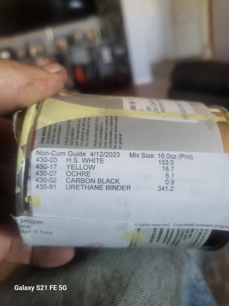

This is off my pint can of PPG Daffodil Yellow paint. Most of it is Greek to me. Envirobase
Brand Code. 81500. Main Layer. 81500
SKU. Desc. Inc.(part). Cum.(part)
T400. White. 506.9. 506.9
T4281. Solid Yellow. 43.0. 549.9
T422. Yellow. 41.1. 591.0
T426. Yellow. 22.9. 613.9
T404. Black. 18.7. 632.6
Comments: Use undercoat G1 for best results.
I hope this helps. Actually comes out as same as GM Butternut Yellow.

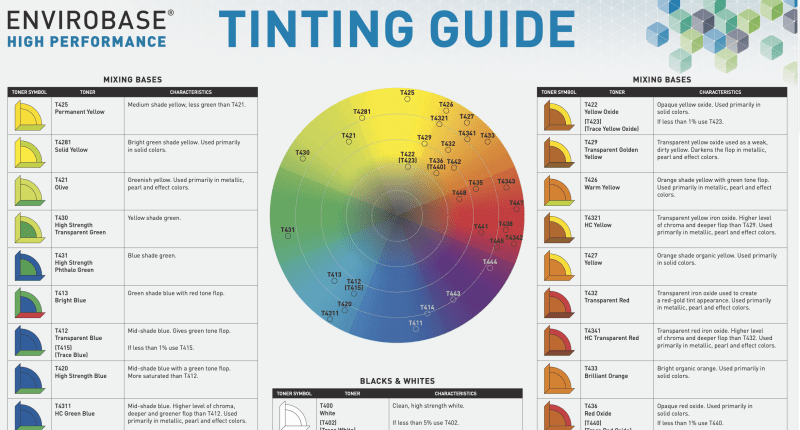

https://assets-us-01.kc-usercontent...f/ENVIROBASE-HIGH-PERFORMANCE-TINT-POSTER.pdf
I see Envirobase says their black is a "blue/black", so there is some blue in the formula
yellow, blue, and red make brown......... be careful
Oh yeah, I paint watercolors and get good results using complimentary colors, but only in very small amounts. Like you say, they turn colors to mud quickly. When I find a label with percentages, I'm guessing they will be minute quantities.

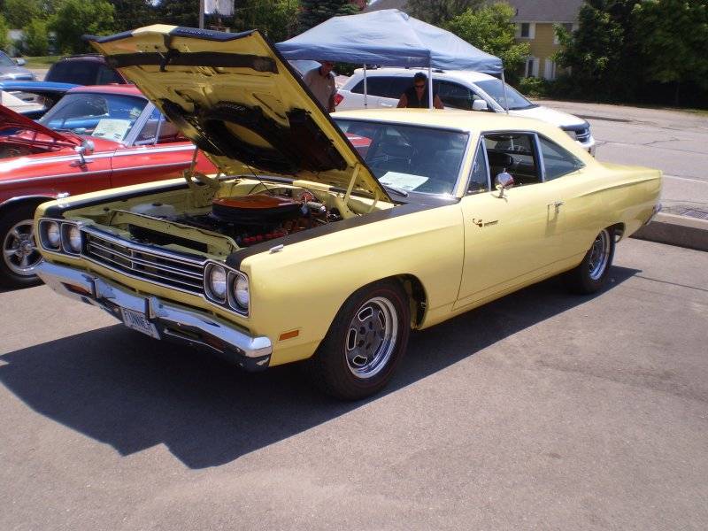

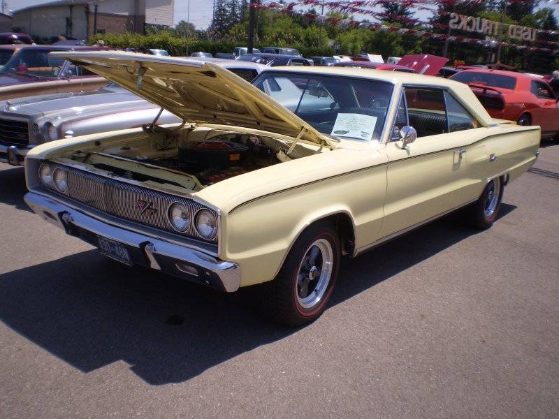

How about some pictures. How close is it to Y2 Sunfire?
Paler. Sunfire Yellow looks like it has some green in it. My Daffodil Yellow R/T and Sunfire Yellow RoadRunner. Pictures taken on same day at same show.
