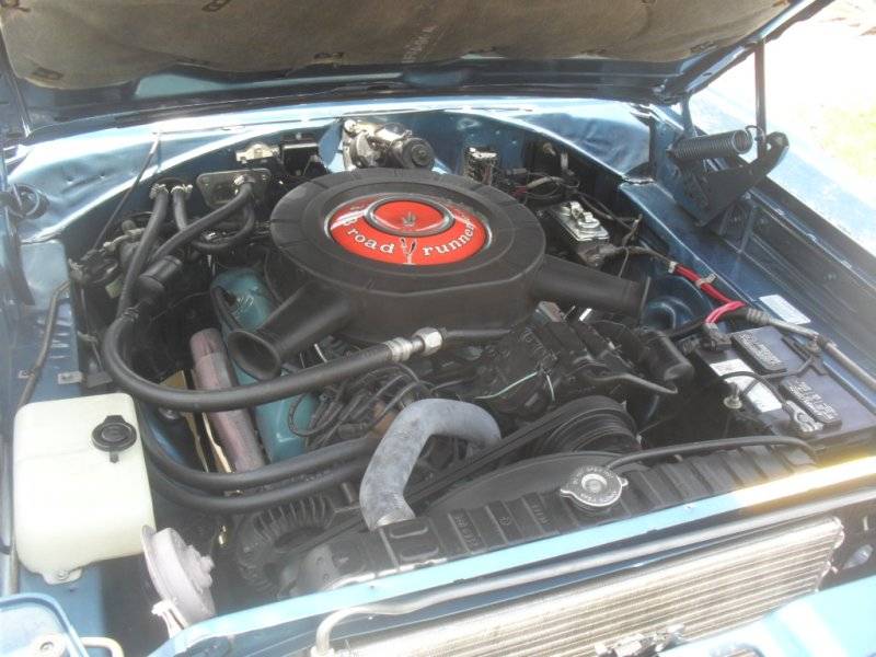

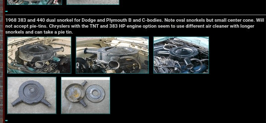

Im working on my 69 rag that has a 383 4 barrel with air. I have seen both types of air cleaners on 69 383 cars. What is right????

Back in 73-77 time frame I had a buddy with a Charger 383 w A/C which should be a 330 hp that had an unsilenced air cleaner.... So I don't believe that is what triggers the air cleaner selection..
Depends (at least partially) on whether it has a California noise package.
(Silenced air cleaner, hood blanket, turndown tailpipes, instead of tips.)
Has it got a holley or a Carter?

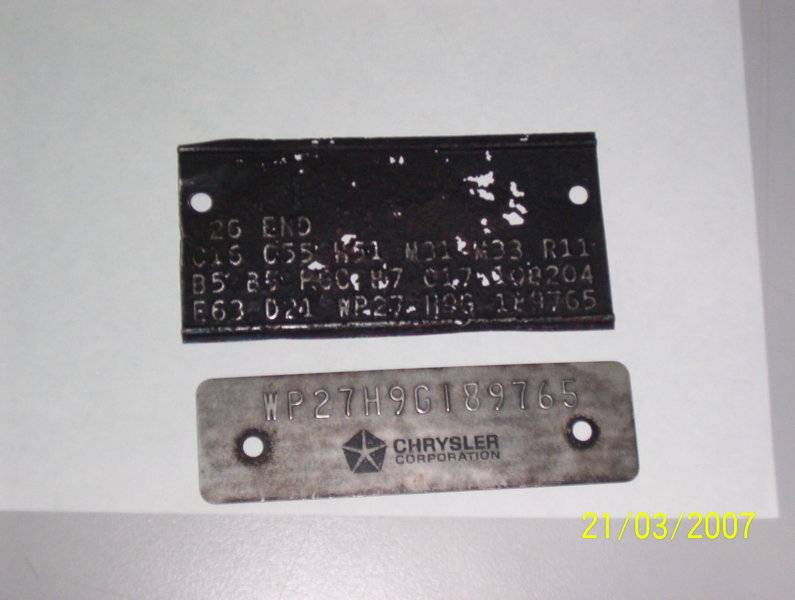

It has a carter. From what I know all 383 air cars were only 330 hp blue block. Even if the vin has an H in it like mine, air cars were only 330 horse not 335.
My reference book is 250 miles away, but.....
I think with your turquoise engine, it probably needs to be the silenced one in the first pic.
If I remember right, 335hp engines were hemi orange.
And I'm a bit confused. I thought the 335s got carters, and the 330 horse cars got holleys.
Does your car show any indication of a hood blanket?

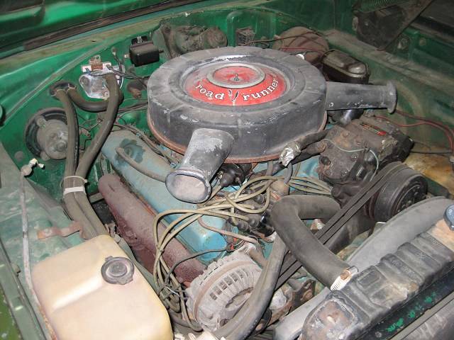

The car that has silenced air cleaner also has hood blanket. A/C RoadRunner and SuperBee got 330 h.p. turquoise engine with Holley. I bought a new 1969 Super Bee with orange 335 h.p. 383 with Carter AVS. A friend of mine had a 1969 Coronet with turquoise 330 h.p. 383, and a Holley. At the time, I thought I got screwed on the carb choice on my engine, believing all the hot rod magazines' hype of superiority of Holley carbs. Both engines were "H" code on VIN. At some point in 1969, the orange 335 h.p. engine became optional in regular Belvedere/Satellite and Coronet. I have seen original cars with this, and was surprised when I first saw it.
The car to the left in my avatar is a 383 4bbl with a factory unsilenced. AC car, turquoise 330 motor. I'm the 2nd owner.
The real answer is - It depends. What plant built the car, was it originally a California car. etc.
Back when I was working in my Dad's Sunoco station there was a customer who said he really liked the Roadrunner, too bad it didn't come in a 4 door. I chuckled to myself. A couple of months later he drives in in a beautiful copper coloured 4 door Sport Satellite. I popped the hood and there was an orange 383 complete with the unsilenced air cleaner and 383 Roadrunner pie tin. That would be a neat car to own now, but I'm sure it rusted out long ago
If memory serves, there is a code on the fender tag (probably on LA built cars) to indicate the california sound reduction package. If that code, or the hood blanket is present, a silenced aircleaner would be correct, otherwise likely an unsilenced would be correct.
It would also have turn-down tailpipes; no chrome exhaust tips.
Interesting info.
My 68 383 4bbl non-ac Charger pad stamp is 1/22, so l would have thought l should have gotten the silenced, as that's what it shows in the OEM buyers guide, but based on Nickels garage info, my unsilenced air filter is correct, phew!
