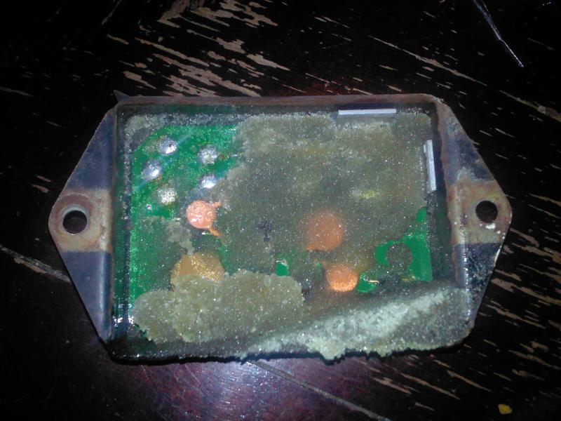

probably some sealer or gel (insulation) out of the capacitors. capacitors seem to always go early nowdays. trash and replace before it totally lets you down.

It's GOO. (Seriously, it's a gel that they put inside electronic components. Suggestion, don't mount it near HEAT and you should use the bracket that permits air movement.)

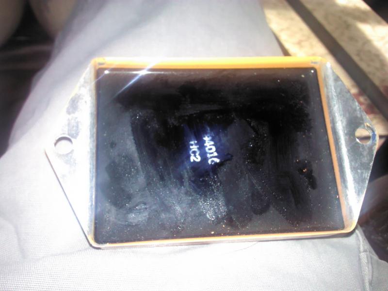

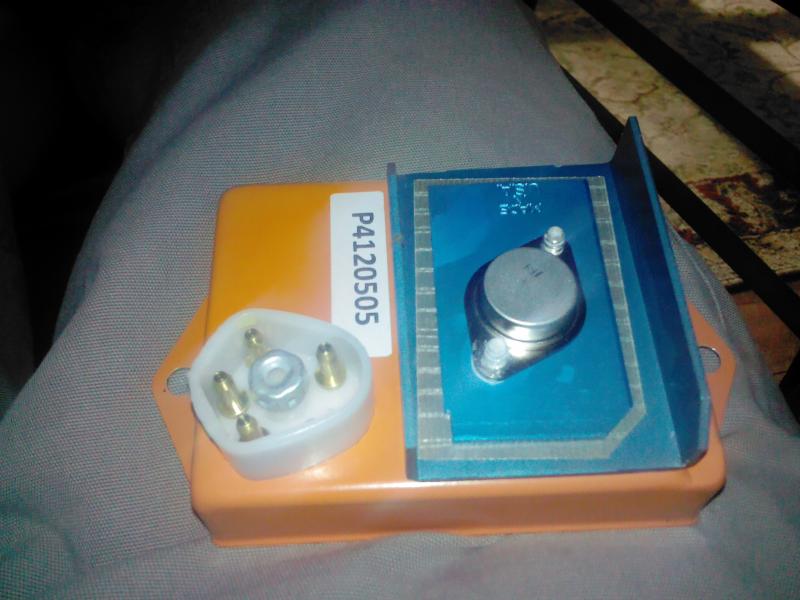

Though that rev-n-nator does look awesome I already have this one I bought for my 440 swap and if my machinist ever finishes balancing my rotating assembly I can get that together. I will prolly give it a whirl on my old 318 for now. Here is what I have from mopar performance. IMG_20130616_081331.jpg IMG_20130616_081342.jpg you can see the stuff in the back of this one must be what's leaking from my stock unit.

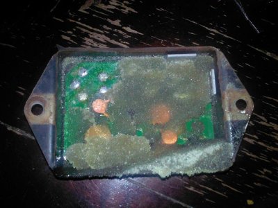

Here is a pic of the original I just pulled. Question why does the original have 5 pins and the mopar performance only have 4 ? IMG_20130616_090040.jpg
Well apparently the 5 pin old ecu's only work with 4 pin ballast resisters and the 4 pin ecu's work with 2 and 4 pin. I put it in and it is running I was just a little concerned because I touched it on the little round thing to see if it was warm and I got a little shock not bad but its there.
5 pin is for the start bypass.
They have a heat sink on them so they will run a little warm.
They also need to be good and grounded so make sure the mounting bolts are tight and have a good grounding connection.
