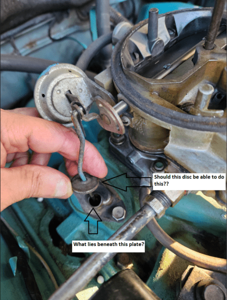

What is under this plate on my inlet manifold??
SOB59
2:08 PM
Mar 14, 2023
17
18
Adamstown, NSW, Australia 2289
While taking off my air cleaner for the first time I noticed this round disc loose. What does this do & should it be loose?? Also, what is under this plate the disc seats on?? Be easy on me I'm still learning... Hah Hah!!
Oh and the motor is a 361.......
Yes, it's suppopsed to be loose. Under the plate is your choke spring that heats up when the engine is on. It opens & closes the choke on the carb.
That helps keep the heat in the choke well and dirt out.
