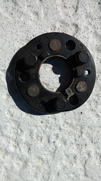

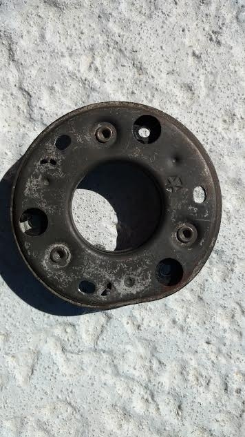

I replaced the horn relay and the horn began to work correctly the day I posted my "After 4 years everything works thread." That euphoria did not last long as the horn went off by itself in the garage the next morning. Nobody near the car for over 12 hours- at least it had the decency to not do this in the middle of the night. It seemed like the horn would go off if you could get the horn ring in just the right position. I disconnected horn and then the relay completely as the horn relay was hot even with the horn disconnected.
I took off the horn ring and found the following shown in the two pictures.
Note in the first picture that the screw hole at approximately the 8:30 position has part of the screw surround missing. Is this likely the cause of my problem? If so, is a salvage yard the only source for this part. Part has three numbers stamped on it. 58301, 1576 and 2771534.
Also unsure if this was installed correctly. The flat side was toward the bottom which put the wire connection at about the 5:00 position. There are also two raised nubs in the first picture at approximately 10:00 and 6:30 I have no clue what the function of these might be.
I have read posts about people cleaning up the horn contact surface to try to get the horn to work, but my problem is not getting it to honk, but instead getting it to stop.
Just make sure to have a good look at those switches. I'm only saying this because when I searched out a replacement for my A100 pickup, I discovered very subtle differences in the 'clocking' positions of the mounts and the tangs for locating the switch. The one I needed was of course the most difficult to find. :rolleyes:
For $80 and shipping, you don't want to make a mistake. :thumbsup:
$80! Sweet Jesus!
Okay, I tried this. Sprayed the thing down with WD-40 and tried to clean any grime off especially around the heads of the spring slides that look like rivets on the other end. Bent the two contacts pieces so the gap was 100% consistent all the way around. It was not coming close to touching anywhere, but the gap was narrower close to one spring slide. Reinstalled and left out the screw that looked like the screw surround was broken toward the outside edge. Works for now. We will see for how long. Those everything working intervals can be short on a 50 year old B body!

Thanks! It never occurred to me I might have the wrong screws. Mine was attached when I bought the car with screws that are inside of the recessed holes, but none have the plastic insert. I may just need the correct screws with the inserts. I would spend the $80 and buy the whole kit new if I knew it would fit a 67. The listing says through 66 for some reason.
Update. I found the exact same part number switch I have on ebay for $24 shipped and three NOS screws and inserts for $20 shipped. This should resolve my issues. I had no idea there were supposed to be surrounds on the mounting screws. My screws were inside the holes and screwed tight to the steering wheel. I hope my threads in the wheel aren't screwed up from incorrect screws. An old Mopar is like a box of chocolates - you never know what you are going to get. Mine had the wrong screws and also no horn relay or horn wiring whatsoever under the hood when I bought it. I hope this car appreciates being brought back to like, although at times it has seemed to be working against me like it just wanted to peacefully slip quietly into full retirement at it's final resting place.
