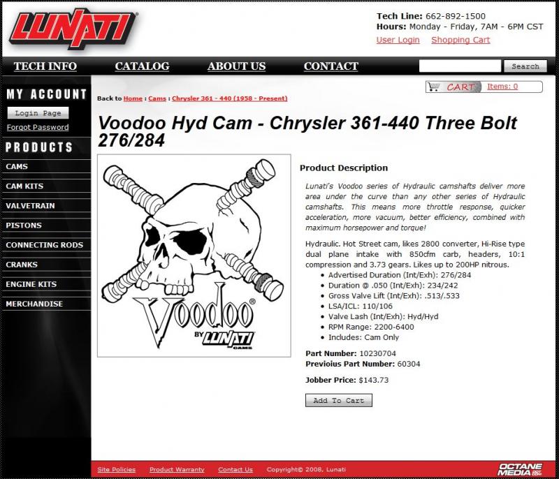

Lunati voodoo cam 60304 hydraulic cam
That Lunati 60304 number comes up as a Buick 455 cam. Mayby Lunati's site is AFU ?

Those guys @ lunati are messing with part #'s. it used to be that #

M79ded: That Lunati cam seems milder than what I have now. I am not nearly as knowlegeable on cams as you may be, but I wonder how that might work with 53 more inches than a stock 440. I guess I'll have to call and talk to the techs at Lunati. Thanks for the suggestion.
