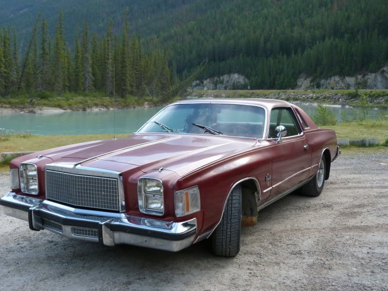

here's how the car looks now:
hood, doors and rear qp's took a good beating. what looks like dust is faded paint.

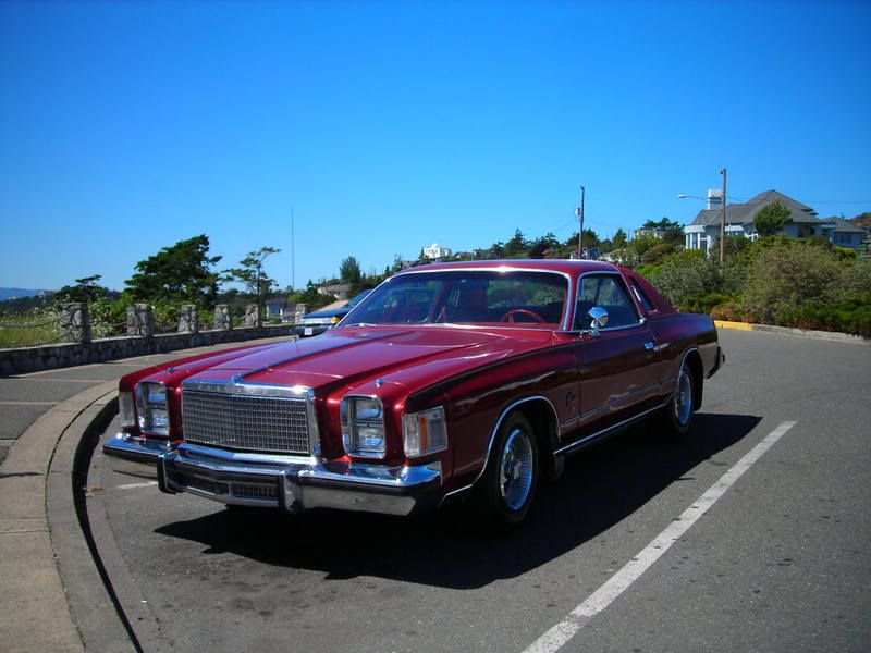

how the paint used to look (1-2 years ago)
You have enamel on the car. I wouldn't put sandpaper on it, it may be too thin by now. I'd get 3M or Meguiars products. Get a fine polish, you can't get too agressive. Do it by hand, time-consuming, but if you wheel it, you may burn through. Be careful on edges,peaks etc. After you do & hopefully you have a nice gloss & no burn-through, put a good coat of carnauba wax on it. I'm being cautious, but once you go through the color, there's no going back.
An orbital buffer would be okay. They don't spin fast enuff to build up a significant amount of heat. Even so, if the horizontal surfaces are sketchy it'd probably be better to do those by hand.
It sure is a nice looking car, looks like enamel paint. I would try some cleaner wax combo on it and see if you could bring the color out on it.. Some of the new stuff they have out works pretty good.
So far my plan for bringing life back to the paint is to start with going over the car with a clay bar, then Meguiar's M80 speed glaze or something similar, followed by Meguiar's M07 show car glaze and finally a couple coats of paste wax.
