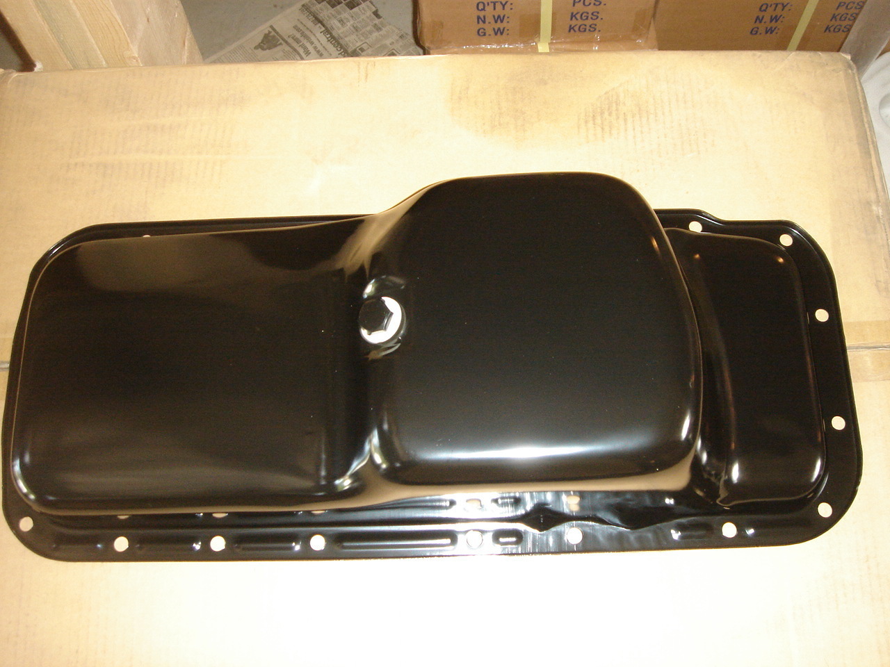

1973 Plymouth satellite was 6 banger 3 speed, changed k frame, putting 400 n 727 in 2nd oil pan will not fit sump on this 1 is back 5 inches
Look for a pan that is stamped #971.
I used a 187 oil pan on the 440 in a 71 satellite. Fit well no issues.
This is the 971 OSDart speaks of... They are close in the design.
I'm not sure the #187 pan will work on the '73 up "B" body. Seems like I ran into this problem a few years back. The sump on the #971 is approximately 2" further back which clears the "K" frame.
Maybe some of our '71 up "B" body afficiandos will chime in?
I believe you are correct on the 971 pan to be the pan to use.
They didn't change the location just the type.. I would still say the 187 pan has almost identical dimensions as the 971.
