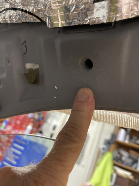

Anyone know off hand what the size thread the seat belt attachment bolt is? I believe its a 7/16 and I’ve tried a few bolts but non fit because they have been painted. So I need to chase them out but need to know the thread size less I pull boner
Be careful, I believe that's a fine thread! Use a seatbelt bolt and check it!
I think? it is 7/16. Definately a fine thread
7/16 fine. You need to be careful though as this arrangement is an interference fit. Keeps the bolt from coming out. Don't remember if its the nut or the bolt, just be careful there.
Thanks guys. Yup I was thinking its a 7/16 fine by looking at. I also tried a 7/16 x 24? but it only started and got tight. I didn’t know this was an interference fit. This certainly explains things about the nut side (my wife would be thinking of my side of the family lol).
