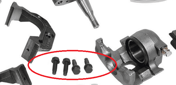

Friend of mine had a bolt come out and leave the building... Its the bolt that holds the caliper bracket in place. Does anyone know the size of this bolt. I mean I was trying to get ahead of the car coming here and have the parts on hand. Its a 1971 Satellite But has an aftermarket spindle and I believe it was the brand that summit sells. Pretty sure its the ones in the red circle. Thanks.

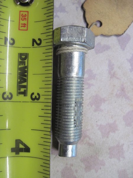

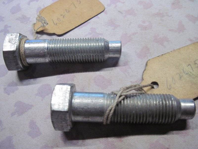

Here are some nos caliper bracket bolts that I have which are 1/2 x 20 fine. A bodies us smaller diameter bolts.
