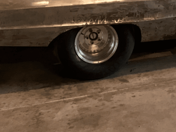

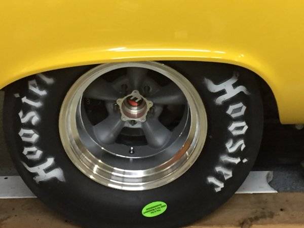

I’m running 31x16.5x15 Hoosiers thinking of going with Mickey Thomson 32x17.5x15 street et for playing on the street

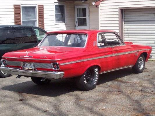

I run Hoosier radial slicks 30 x 9 x 15. And I drive on the street with them which I have been doing for over 6 years. But my car is not tubbed as I have stock wheelwells. Yours must be tubbed to fit such a big tire under it. I will say that I run a radial street tire up front (215/70-R15) and when I went to the radial slicks in the back over the bias Hoosier Quick Time Pro's I used to run it now handles better then it did before since I have radials on all 4 corners. Good luck with yours, Ron

Yup my coronet has been back halfed

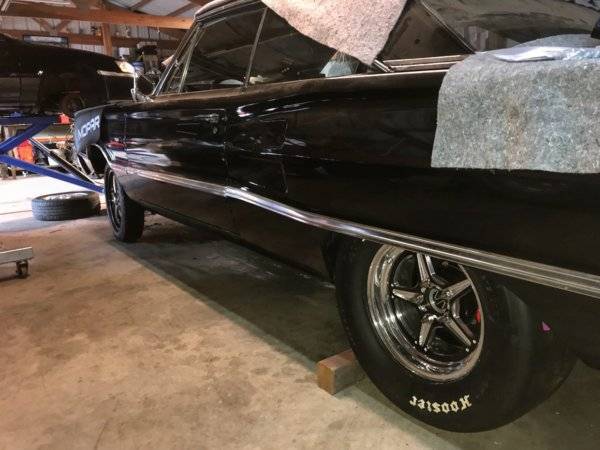

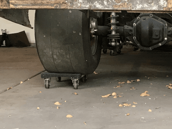

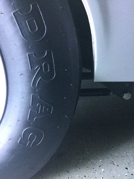

I run MT ET Drag 28x9’s. I’ll be do for a set next year and already know I’ll go to Pro Bracket Radials. As most here are familiar with, the 66-67 body limits what you can fit.

Do you have these on 10 or 12" wheels GITEX

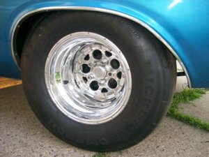

M/T 29.5 X 10.5W's for slicks on my 70' Challenger & also 315/60/15 M/T Drag Radials for the street & running in our local Drag Radial Class. (just on for mock up here).

Ron, nice pics of your ride on the cover of Mopar Muscle..

I have to drop my axle down to get my rear tires & wheels off of my Challenger also. It's a tight fit.
