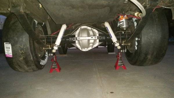

I now have 2 races on my new Hoosier Slicks.
They are the Hoosier #18175 29x10.50x15W. 29.3" tall, 93.5" rollout, 11" tread width and 13.2" section width. They are the STIFF SIDEWALL tire. I also run tubes to make the sidewalls even stiffer. Before these tires I had a set of M/T ET STREET slicks. 28x13.50x15, 11.2" tread with, 13.2 section width, 88" rollout. When I launched my car off my transbrake it literally "crushed" those tires. Hoosier Tech recommended these stiff sidewall tires for my 3800lb car. They still "wrinkle" on the launch at 3600rpm off the transbrake but they are not getting crushed like the M/T's. I run 17lbs of air in these Hoosiers. I am going to experiment at the March Meet Test and Tune at the end of thisFebruary with trying to launch at 4000rpm off the transbrake with 18-19lbs of air. My 60' foots now range between 1.40 and 1.43, not great but it still puts me in the 10.17, 10.18 and 10.19 about every run.
I run a 4.30 gear in my Dana 60. With the 88" rollout M/T's I went about 129.5 at 6900 thru the lites. Now with the 93.5" rollout Hoosiers I go 131.5 at 6900 thru the lites. The taller tire did NOT hurt my incremental times at all. The motor still had enuf "grunt" to pull the taller tire.
PS: My rear end is narrowed and body is mini-tubbed to get these tire to fit. I have to let the air out of them to get them in and out.

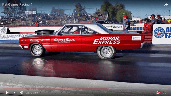

Below are a couple of screenshot pixs off of the Video of the car launching.
The top picture is RIGHT WHEN I LET MY FINGER OFF THE TRANSBRAKE BUTTON,
the other picture is about 15-20 feet out from the start line.
Also if you look closely at the bottom left of the pixs you will see that the 1st picture is 37 seconds after the video was started and the next picture is 38 seconds into the video. A one second time lapse...pretty cool I thought.
By the way, I did outrun that white altered wheelbase HEMI car on this run. I went 10.22 and he went 10.29. I was at the California Hot Rod Reunion at Famoso (Bakersfield).​

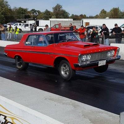

This is the only launch pic I have on the radials but you can see the sidewalls don't wrinkle much at all like the older bias slicks did. Your car looks awesome on them slicks you are using Mike ! Ron

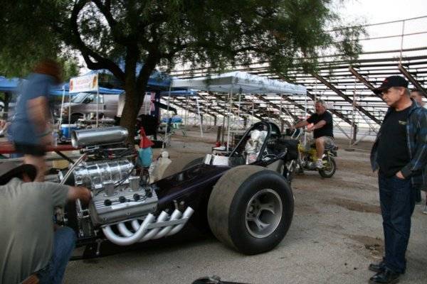

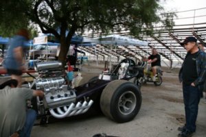

best slicks I ever had -no longer available were the firestone 14 32x15W 9N compound, those tires would literally hook up on dirt. so much so the dang sprint car racers started grabbing them all and grooving them for their dirt track cars- point moot, long gone tires but that was it in the mid 70's, today's tires I'd try are the Hoosiers ,I have new M&H 1200-13 x 16" on my dragster. I know- not the same..
PAS the man with the dark clothes standing in the picture is Jeep Hampshire former driver of the Stelling and Hampshire AA/FD of the 60's
