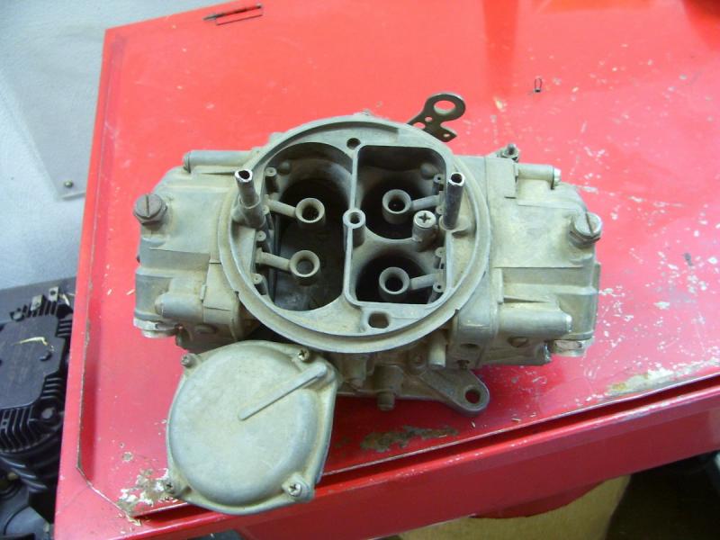

hey rusty, one of these,...:blob1:.

Yeah, but that's a 3916. It's a 950. The 1050s had dump tubes in the rear with no boosters. I sorta want to try one on my 383. Either one would probably work.
yep, it's a 950. i did have it on my 383 road runner, way back in the day.
