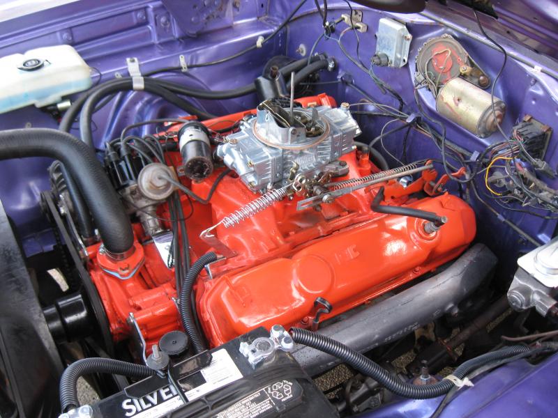

right now as it sits, there is a holley 4 BBL on it. it works perfect with the air grabber hood and gasket. i believe the holley is a 650 cfm and its brand new put on by the dude i bought it from. this engine is set up perfectly and thats why i am apprehensive to F*$@ with it. the fast idle is perfect and i doubt the starter turns even once when starting hot or cold. absolutely no issues what-so-ever. it fires right up everytime ! maybe i will just leave well enough alone. i got all my ya-ya's out when i was a kid ...i just wanted to see if there was anything available that was modern ! thanx a million guyz!:headbang:

Only updated things you can do is to upgrade to fuel injection or roller cam.
But if it not broke, and your happy with what you have, I would leave it alone.
Both can be pricey, and you might not be happy with the performance results, compared to with what you have now.
I'd be inclined to not make any big changes if it runs that well. However I would want some data out of it. Do a compression check and plot the timing curve. Almost any engine can do better by dialing in the timing. Focus on maximizing what you have.
After building my stroker 440 to 493 and spending ALL SUMMER getting it dialed in I would say just leave it alone and go freakin enjoy the **** out of it :) I am finally getting to enjoy long drives in my beast lol good thing we have good dry weather here right now.
yeah...thanx for the input guys but i think i will leave well enuff alone! "if it aint broke,,,,,dont fix it"
